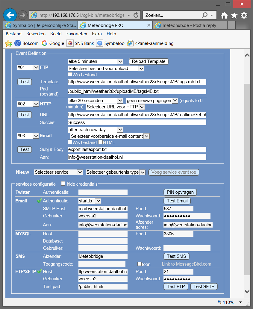

Cant say without knowing your settings. I doubt that it is a bug, sounds more like a service misconfiguration to me.
Re: Iso template
Can you post a screen shot of your services page? And the modified template.

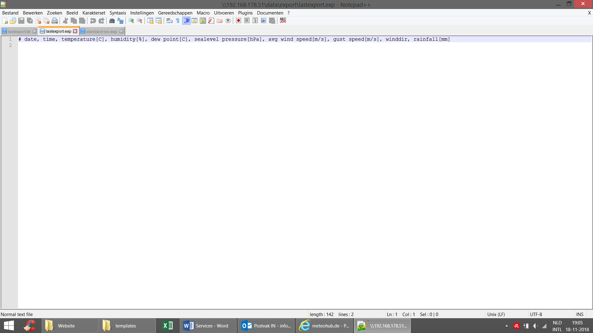

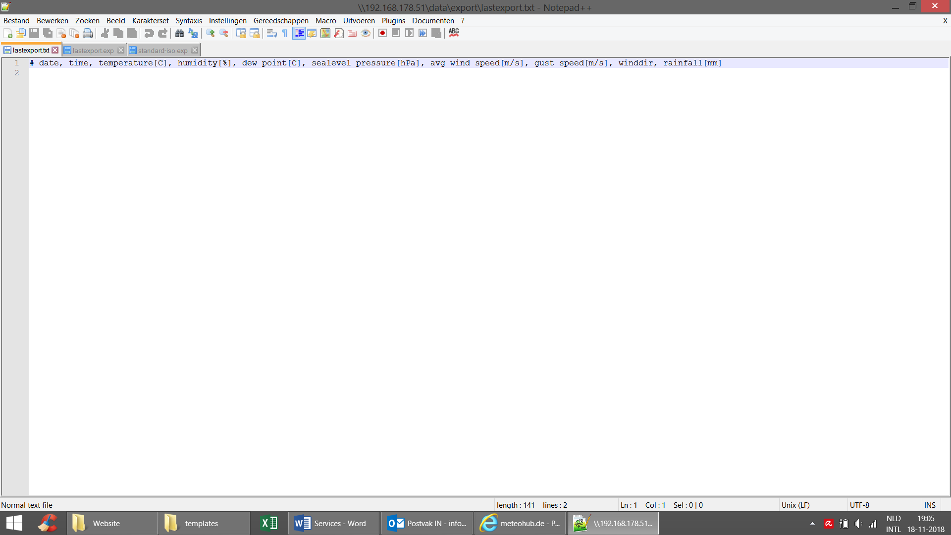

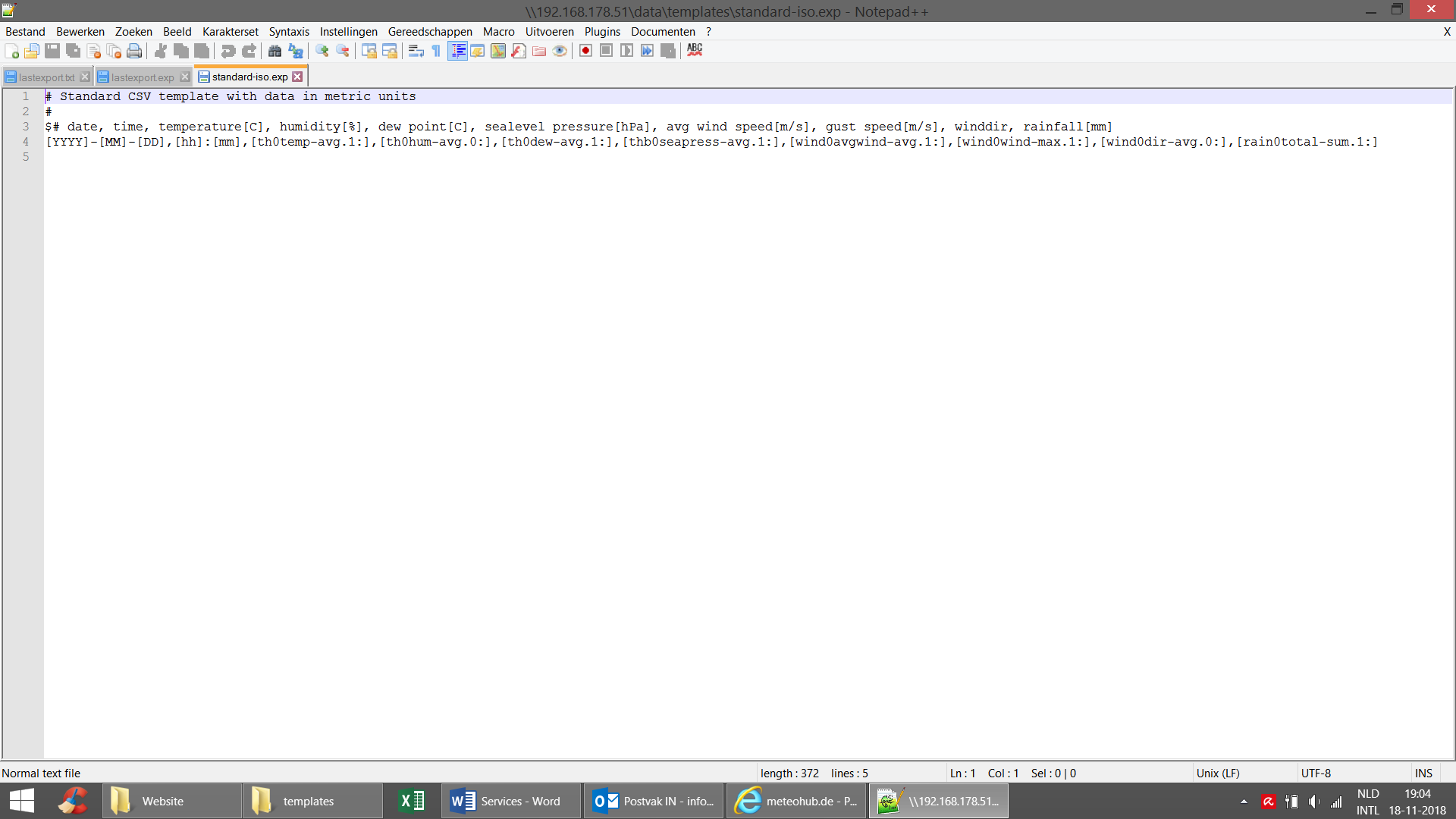

Post by oudmans »
Here the printscreen of my services and the standard iso file and lasexport files

I cant see any event that generates the export file. Without that nothing interesting will be uploaded.
Please start reading here "https://www.meteobridge.com/wiki/index. ... SV_Exports" to understand how to setup this. I made the effort to describe it, so please invest your time as well and read it.
And please don't paste unreadable screen dumps. When you have files to share, please share the files or copy the text inside a code section in the posting.

Hi Admin,
Sorry for the screendumps.
I read the article and it is now clear how ik works.
Thanks for your explanantion
