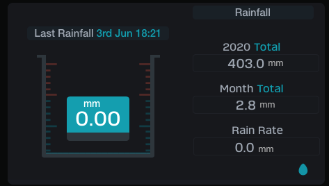

Hi there thanks for looking at this. We have rain for the first time this morning which then created a new var/run/meteohub/nonzerotime-rain0total entry.
After a reboot, the values are still here. Will check in a moment that the file still exists...
ConligWX
Posts: 329
Re: Nonzerotime after few days empty?
Post by ConligWX »
ok got home checked the
/var/run/meteohub/nonzerotime-rain0total file but it is not there. there is however a update-rain0total file which I guess is the new "last rained file" ?
data on website is still showing correct last rained value.
