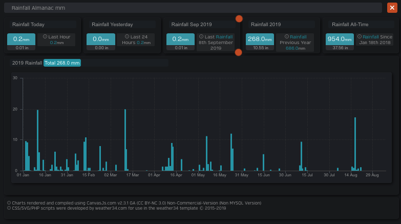

ok i updated 8th September 4.1-2424 and went out poured a bit of water into the cone to generate 0.2mm ,
it now generates timestamp i can edit out after a few days so lets see if it picks up the [rain0total-nonzerotime:--] as of todays timestamp 20190908155729 so lets see if it remains there in a 2 or 3 days as what use to happen it would revert back to -- .
screenshot shows with the orange dots ..brian

Re: Nonzerotime after few days empty?
hello boris unfortunately that didnt work after 3 days exactly no timestamp is returned only —
so i dont how else to return a last rainfall date with a valid timestamp
brian
