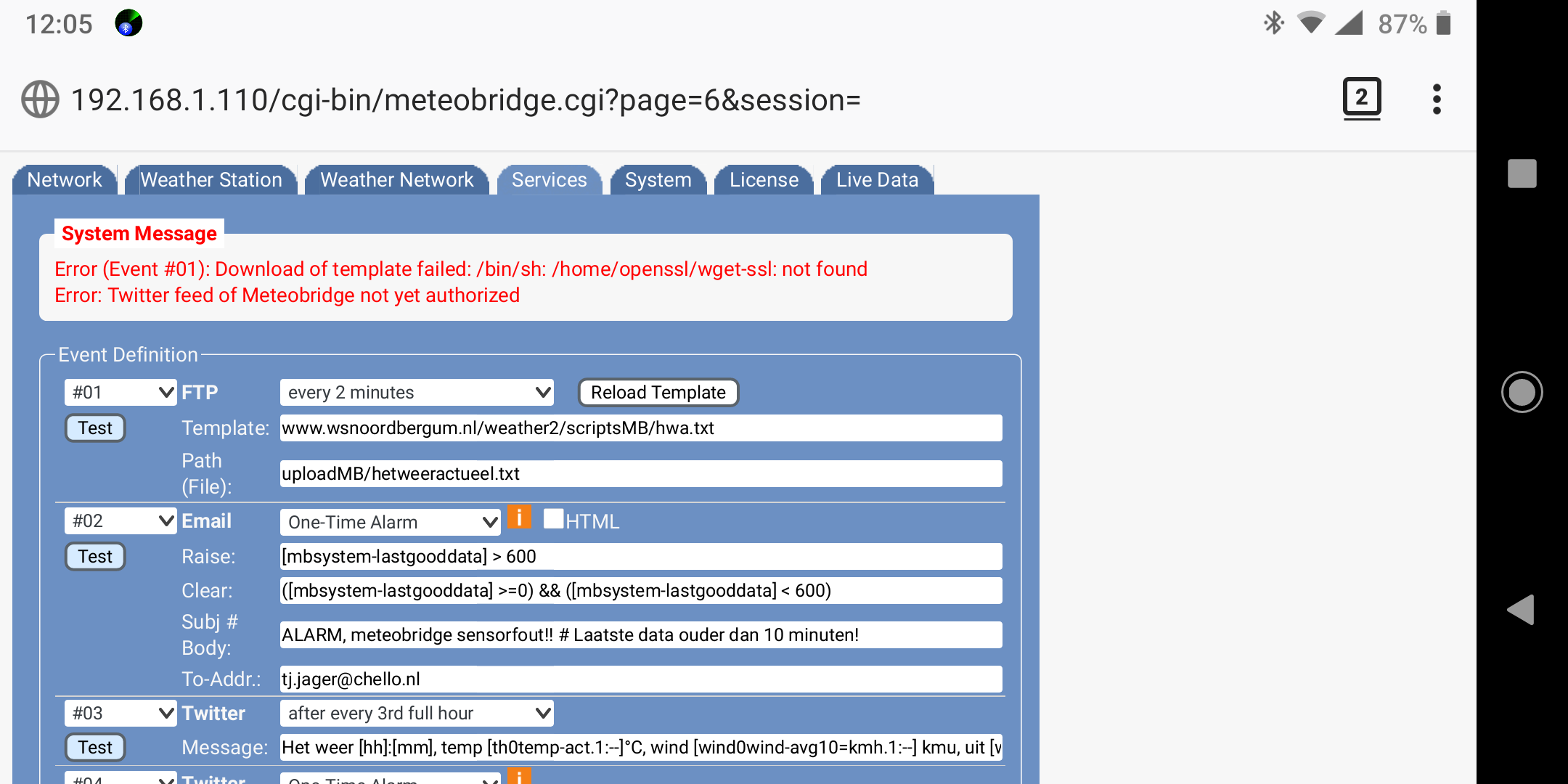

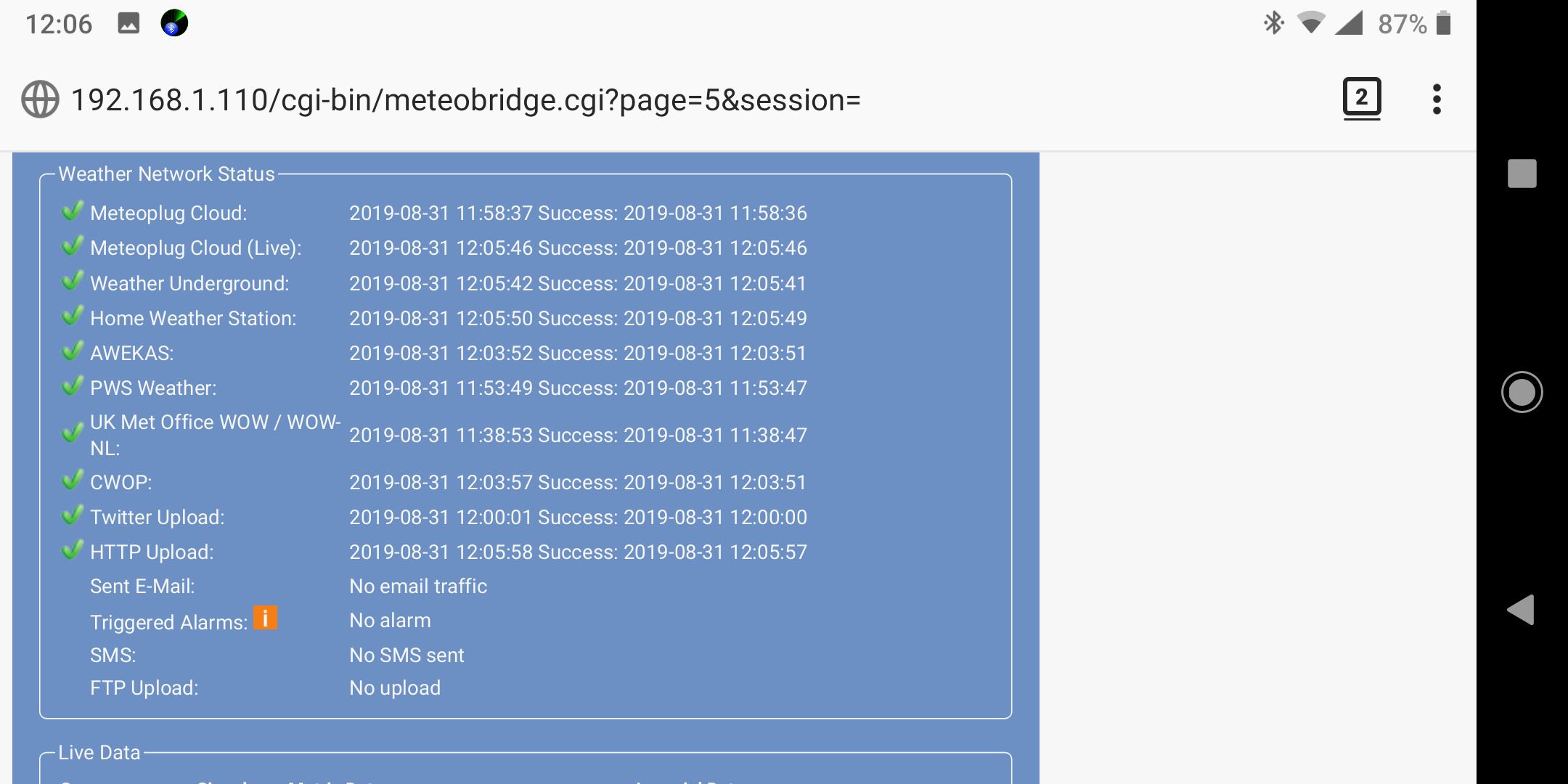

Seems like you already rebooted my device.
The FTP upload does not work.
Also my data gone ..... again.
Also reload template results in error.
See attached screenshot.
This is not good.

I'm seeing the same issue on 4.1 for MR3020. It's complaining about SSL so it cannot download my template. I reverted to 4.0 and it is working again.
4.1 was giving an error about ssl not being compiled in. My template is on a site secured with TLS 1.2
