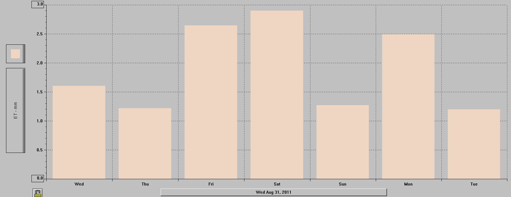

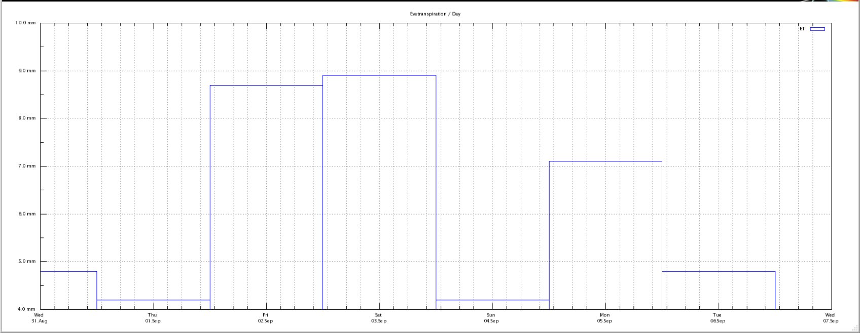

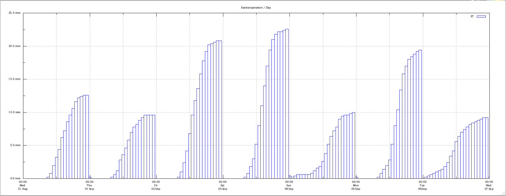

I've tried to sum up what I see on my unit:
(Excuse the graph sizes)
The daily report over the last 7 full days using MH graphs (Interval 1 day)
The hourly report over the last 7 full days using MH graphs (Interval 1 hour)
The daily report over the last 7 full days using Vantage weatherlink graphs (Interval 1 day):
And last but not least the raw values from Meteohub:

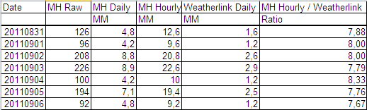

I've put the whole thing in an xls for comparison purposes:
Keep in mind that I've tried to read the graphs and translate them into numbers, so might be slightly off.
So it seems that we have 2 issues:
1) The MH Daily interval is broken those numbers are not getting close to the raw values
2) The Meteohub raw numbers are in sync with the hourly reports, but about a factor 8 too high. This was reported by others as well.
