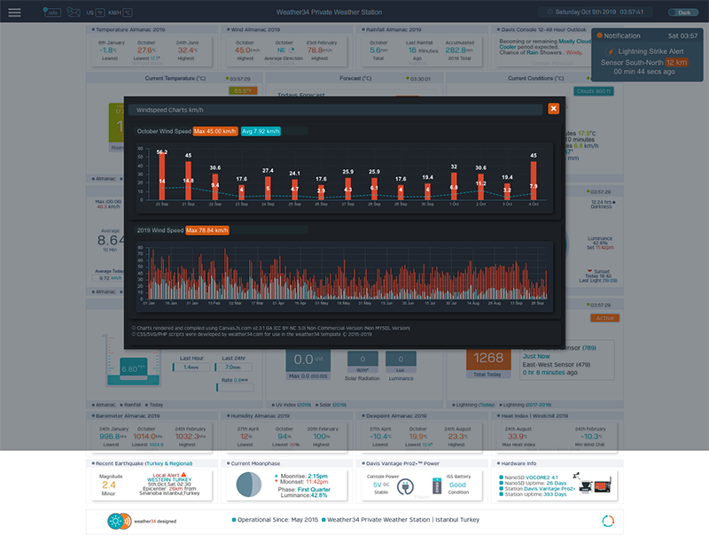

weatherist34 wrote: Fri Oct 04, 2019 7:52 pm
when i get time i will publish a page how to actually run a export in same structure,format from nanosd so that would allow past years of data to be used .unlikely in the near future at the moment.
for now it runs from the day you install and no before anyone asks will it support weather underground history.. :D
not I didnt have any previous versions of meteobridge template. though I imported ALL my weewx and cumulusmx data into my NanoSD right back to 2013.
Yes that would be great to allow a page to export the data, or just create a Template that we could use to export.
for a complete year or year to date
date(date month-0)=[DD]/[MM] // 01 Oct
MAX(Temp-1)=[th0temp-dmax:--] //must be celsius
MIN(Temp-2)=[th0temp-dmin:--] //must becelsius
MAX(Dewpoint-3)=[th0dew-dmax:--] //must be celsius
MIN(Dewpoint-4)=[th0dew-dmin:--] //must be celsius
TOTAL(Rain Day-5)=[rain0total-daysum:--] //must be mm
MAX(Windspeed-6)=[wind0wind-dmax:--] //must be ms
AVG(Day WindSpeed-7)=[wind0wind-davg:--] //must be ms
MAX(Barometer-8)=[thb0seapress-dmax:--] //must be hPa
MIN(Barometer-9)=[thb0seapress-dmin:--] //must be hPa
MAX(UV-10)=[uv0index-dmax:--]
MAX(Solar-11)=[sol0rad-dmax:--]
template charts takes care user preferences for metric / non metric as templates converts from these default if you exported in non metric then all conversions in template for charts go wrong . template always converts from metric..m/s..hPa etc
12 chart positions designated by the number i.e MAX(Temp-1) position 1 MIN(Temp-2) position 2.
it is quite a simple structure
[DD]/[MM] [th0temp-dmax:--] [th0temp-dmin:--] [th0dew-dmax:--] [th0dew-dmin:--] [rain0total-daysum:--] [wind0wind-dmax:--] [wind0wind-davg:--]
[thb0seapress-dmax:--] [thb0seapress-dmin:--] [uv0index-dmax:--] [sol0rad-dmax:--]
end up with csv example
29 Sep,23.8,15.9,17.4,10.4,0.0,4.9,1.1,1018.4,1014.7,5.1,814.0
30 Sep,24.9,18.6,19.3,10.4,0.0,5.4,1.1,1014.8,1009.7,5.6,855.0
1 Oct,26.7,18.7,19.7,14.9,0.0,8.9,1.9,1014.0,1010.5,5.2,824.0
2 Oct,26.7,18.9,19.9,15.8,0.0,8.5,3.1,1012.9,1008.3,5.1,816.0
3 Oct,27.2,20.0,19.6,13.9,0.0,5.4,0.9,1010.5,1007.9,5.4,844.0
4 Oct,27.6,21.0,18.9,10.9,0.2,12.5,2.2,1011.5,1006.1,5.2,886.0
note uv and solar the percentage of users don't have this combination so not required in an export if not present
theoritically should end with something like this .yes Im awake at this unearthly hour due to a strong lightning storm overhead..:-(
Screenshot_2019-10-05 Sinanoba Istanbul Home Weather Station.png (242.33 KiB) Viewed 9143 times

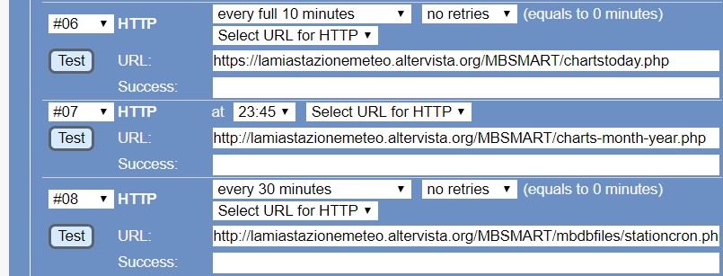

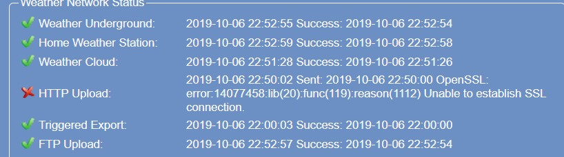

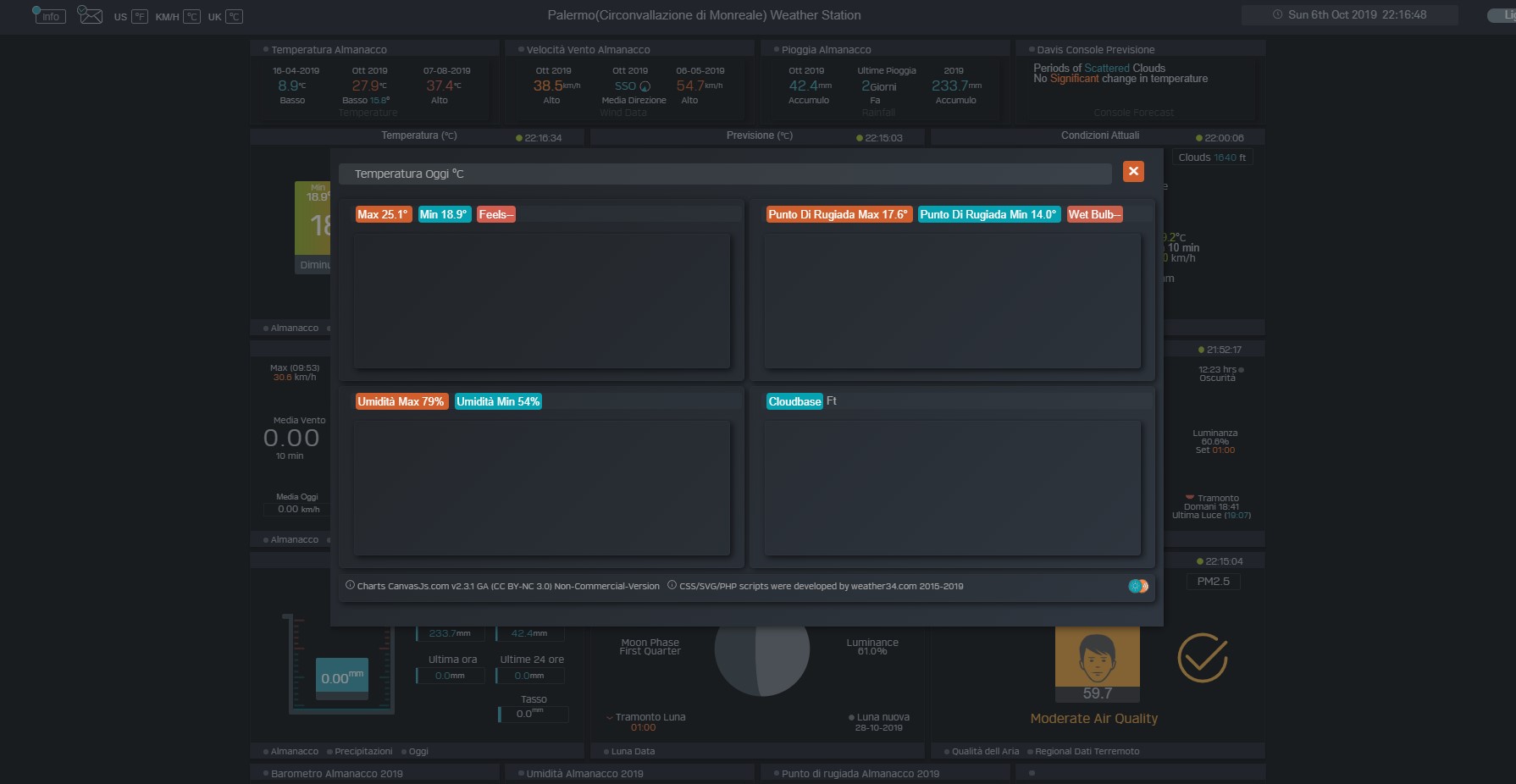

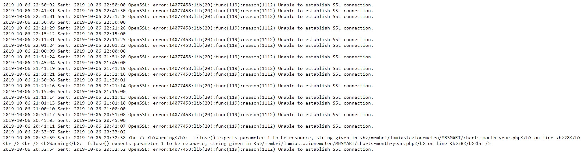

hello, I just saw this new dashboard and I proceeded to install it ... everything works except the graphics, they are all empty ... I don't know if it's normal or not ...
what am I doing wrong??

rzelle-K1TTC
Posts: 243
Post by rzelle-K1TTC »
Hi, It looks like your chart s are net receiving data from the NANO-SD did you setup the services on the NANO-SD as shown in this link.
https://weather34.com/homeweatherstatio ... setup.html
..Ron
rzelle-K1TTC
Posts: 243
Sorry I scrolled past your screen shots I see what is causing the problem your first service is trying to use https change it to http.
xxvincixx
Posts: 63
Post by xxvincixx »
rzelle-K1TTC wrote: Mon Oct 07, 2019 12:00 am Sorry I scrolled past your screen shots I see what is causing the problem your first service is trying to use https change it to http.
solved,thanks ;)

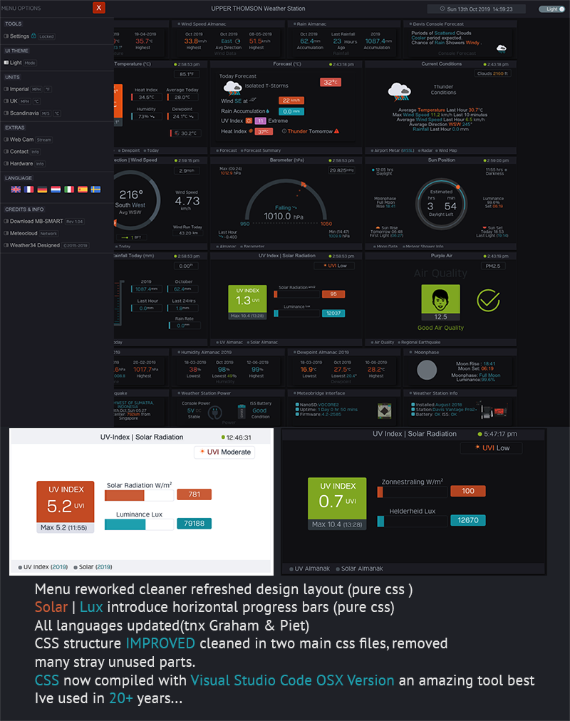

Now nearing the end I think
been getting grips with Visual Code Studio last month or so and finally reaping the benefit in compiling code cleaner and having this is really beneficial to
serve as a designer tool .cant say enough good things about has all the tools any web designer dreams off..
anyway the menu structure was completely reworked and the css files were recompiled and clean up the structure really nicely from a developer point of view and of course allows better and easier adjustments where and when required.
the UV modules were reworked and now include a horizontal bar for solar and lux see screenshot.
a version was forwarded to Boris recently to implement into the NANOSD product so expect something to appear over the winter months here in the northern hemisphere from him..
many thanks to Piet ,Graham,Pedro for help with translations its a slow process and tedious task but each week a bit more gets done on the translation side.
Brian
Screenshot at Oct 13 11-59-35.png (339.27 KiB) Viewed 8993 times
