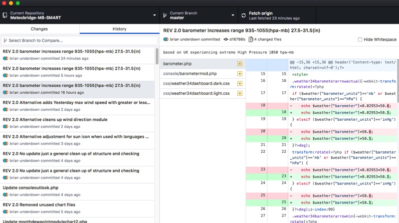

or use a GITHUB app to pull updates, GITHUB offers a full history log and code changes with highlights of actual code changes.
https://github.com/weather34/Meteobridge-MB-SMART
best place to monitor for updates is via https://weather34.com/homeweatherstatio ... smart.html or GITHUB
this thread is primarily for discussing issues or if you get into the habit of using GITHUB you can raise issues directly there and push code ideas via the ISSUES tab via https://github.com/weather34/Meteobridg ... ART/issues

on another subject ive posted below a clear example the benefit of using a GITHUB app to follow updates they are available in many flavors for all OS Mac,windows etc just have to find and use one that suits your needs . You can see it automatically lists all changes in history and code
I use the standard default GITHUB Mac OS version .

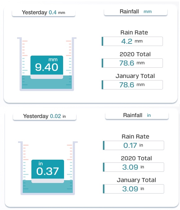

hello Brian, would it be possible (in the alternative console) to change the positioning of mm of rain per day ??? they are the only data that can be read little because of its small character ... perhaps removing it "from the water" or decreasing the size of the tray to allow you to enlarge the characters of the daily mm .... thanks :) :) :)
think Im understanding so I changed it to this simply moving the unit above and increased font size a wee bit and increase today rainfall value font size . If not I don't think its a critical thing to spend to much time on but I do appreciate the feedback and try to cater for most ideas thrown around.

weatherist34 wrote: Wed Jan 22, 2020 10:34 am think Im understanding so I changed it to this simply moving the unit above and increased font size a wee bit and increase today rainfall value font size . If not I don't think its a critical thing to spend to much time on but I do appreciate the feedback and try to cater for most ideas thrown around.
thanks brian, so it is already much better .. :D :D :D
one last thing, you could try to set the font in black/dark grey, instead of white..I think it would look even better and would be more in contrast with the blue water .. obviously mine are just tips and feedback ,thanks for your hard work :) :) :)

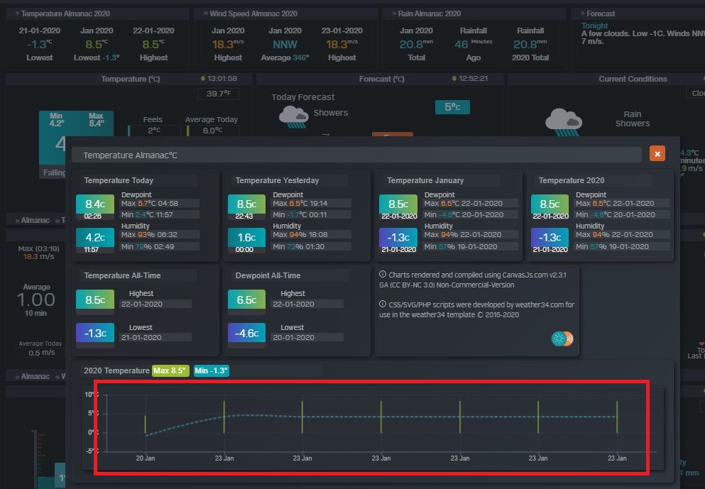

I've already rechecked many times according to your instructions https://weather34.com/homeweatherstatio ... setup.html my settings. But statistics for the day are not saved. For example, it has been three days since the start of work, but the average daily values remained for the first day, and then there is a void.
hello
that is one mind-blowing url :-)
however I have just run the url for charts-month-year.php through the browser you will see it created data for 23rd Jan in month and year .
so check there are no hidden whitespaces at the end of the url in the charts-month-year at 23:45 . also click the test button to confirm it is running.
doing exactly the same from a browser creates updated data. thats all I can think of

As i understand, after runing the url for charts-month-year.php through the browser it turns out such as in the picture, this story can be removed somehow?
