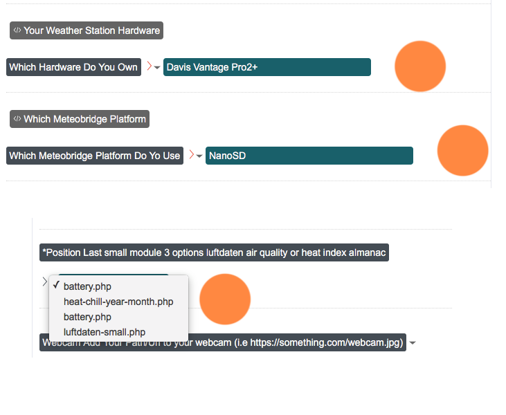

if you goto settings change davis hardware type to davis vp2+ was called davis vp2 pro or something which was too long
change small module option to battery for now until i ask boris to add a few extra heat index/windchill values to the api . no changes were made to anything related to webcam see for example https://www.paulwilman.com/pw4/
double check you updated updater.php and added new files listed in github
each file updated marked with
*Significant Update new files,new modules , new translations rev 1.02
*caution new heat index module data not ready requires new data to be added to API . 23 files were updated . now shows 21 modules ! see https://singaporeweather.info for demo
change the two settings below now uses shorter phrases and change module option ..

all languages files updated *changed options in setup screen + others 13 files
*important goto setup screen change
*mb-smart-setup.php updated
*Which Meteobridge Platform Do Yo Use ? NANOSD or NANO or Pro (now uses shorter phrase does not include meteobridge phrase )
*Position Last small module 3 options luftdaten air quality or heat index almanac change to moonphase or air quality. heat index option is for future change to API
*index.php updated change to recognise new language strings
*hardware.php updated minor change
*updater.php changed updated position options

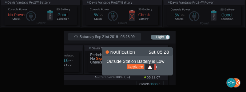

Checked the new Battery module looks great but the console power should 5v DC ..:-)
..Ron
Posts: 1841
Re: MB-Smart Beta hosted on a Synology NAS in US
ha corrected AC input DC output

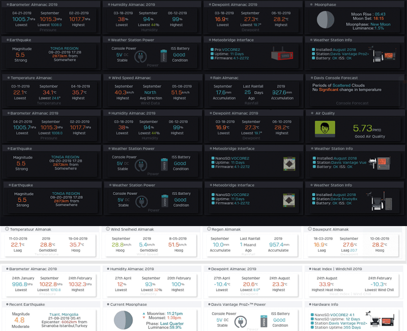

scenarios to indicate low power battery etc notification if it ever happens
thats now 12 extra different modules and combinations shown below.

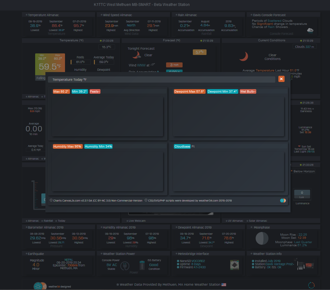

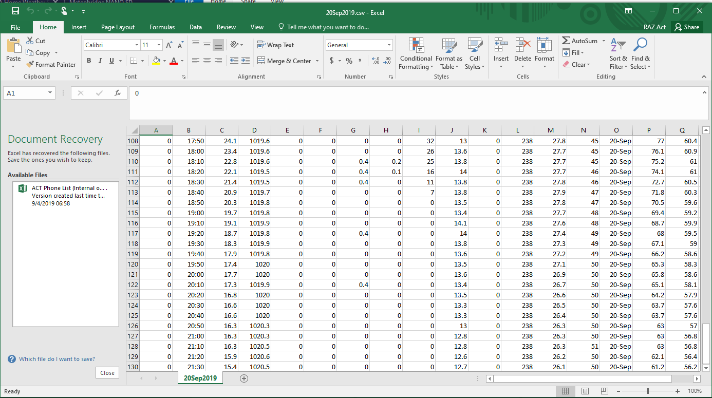

Good Afternoon, My site is updated as of 0740 everything is looking Really Nice!
A Strange Problem with Today Charts..
I kept track of Today charts during the day yesterday only until around 1200 and they charted with data. I then checked Today charts again at 2130 and no graphing which is what I saw the other evening.
The csv file 20Sep2019.csv had data entries every 10min so the NANO-SD was sending data as it should. I tried viewing the Today's Charts via Ipad and windows browsers with the same results. Checked Today Charts at 0030 this morning and they were graphing again.I've attached 2 screen shots of what I saw last nigh at 2130.

Posts: 1841
rzelle-K1TTC wrote: Sat Sep 21, 2019 2:04 pm Good Afternoon, My site is updated as of 0740 everything is looking Really Nice!
..Ron
hi ron you need to look at server errors when this occurs or browser source mode might throw some indication,
if the csv is populated thats all the charts do is read that csv for todays date .
you screenshot this indicates either file cant be reached (was it writing to file at that point?) or momentarily (period) server changes date ahead ? next time look for any server errors or use developer mode in the browser .

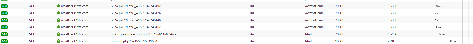

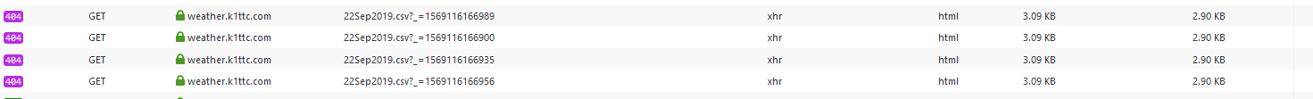

Good Afternoon ... I checked the Today Charts throughout the day yesterday until just after 2015 when they stopped Charting, Browser Network Dev Mode revealed that Charting was looking for the next days csv chart file see attached. I checked Server Time and Workstation Times and all are in sync to my local time and zone. It looks like the the Today's Chart is looking ahead 4hrs. My Time Zone settings are set to America/New_York -4hrs. Ive attached a Today Chart get from this morning as well.
Get Error Todays Chart 1 day ahead.PNG (10.05 KiB) Viewed 5264 times
Get Next Day No Error Todays Chart.PNG (17.86 KiB) Viewed 5264 times
Hope we can figure this one out .. :-)
.. Ron
Posts: 1841
server related im afraid as times are derived based on server php timezone setting ,the bit i dont get new york minus 4 hours as that is the time it starts looking for tomorrows date i.e 20:15 obviously something is expecting 00:15 or later from there on.
i cant help at server level im afraid , ive zero experience of using synology perhaps search around forums related to synology.
