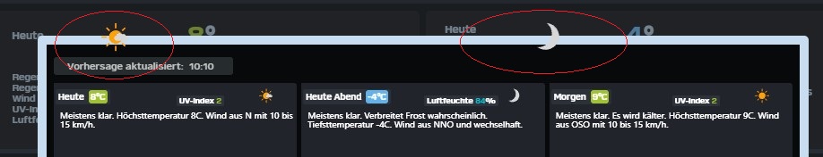

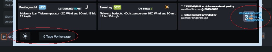

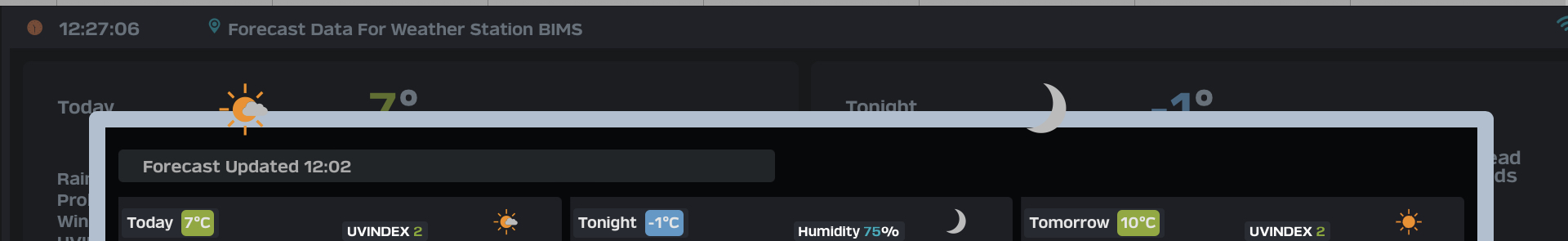

Does anyone have an explanation why the overlay window for the 5 day text forecast under ../forecastcharts/chartforecast.php is not displayed completely on top. There are some elements shining through, see screenshot.
Also, I can click the button several times and it opens a new window each time, normally the next click should close the window again.

yes, also on your Site. It depends on how big the browser window is.

via simple update (I can fix that one has it doesn't require meteobridge data) https://weather34.com
Change Log March 2022
* (March 8th) * Forecast overlay Icons ref Toto (Forum)

Hi Brian :)
Thanks for your help and the fix :idea:

Thanks Brian, it didn't bother me before but you never know, on another device or screen. So it's good that ToTo was saw it.

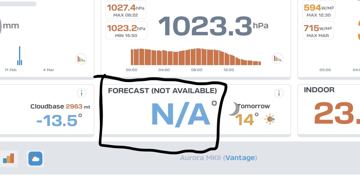

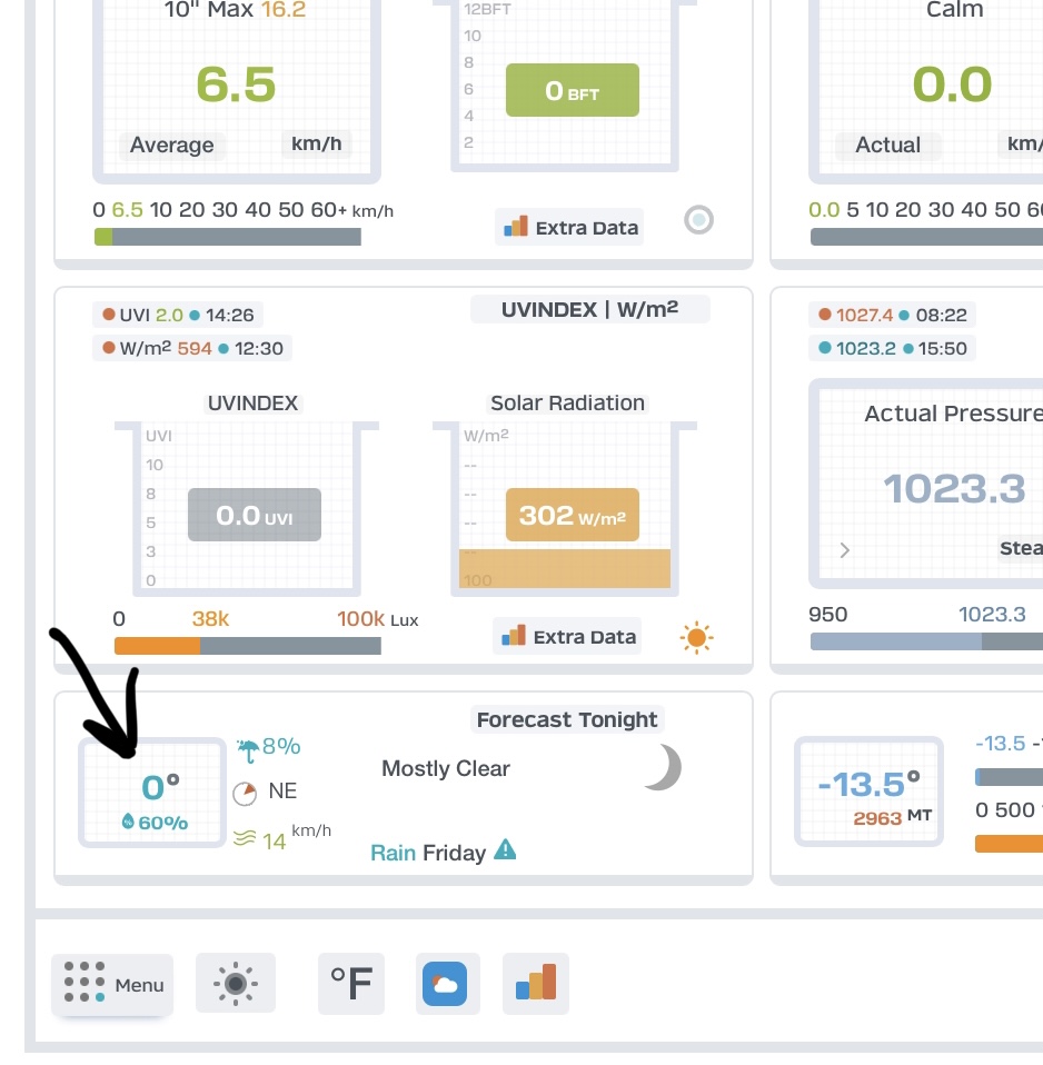

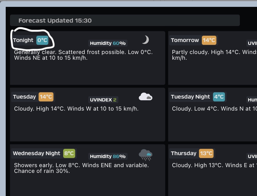

When 0°C is forecast, the message “N/A” appears.
It is not urgent, because the weather will soon be hotter and hotter 😎.

lorenz1982 wrote: Sun Mar 13, 2022 5:16 pm When 0°C is forecast, the message “N/A” appears.
Check your updates.
It works.

Post by lorenz1982 »
jmontamat wrote: Tue Mar 15, 2022 6:18 pm
Check your updates.
It works.
I don't understand, I've done all the updates.
i've same issue...

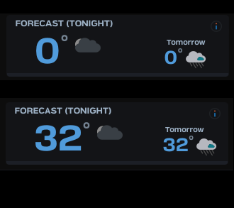

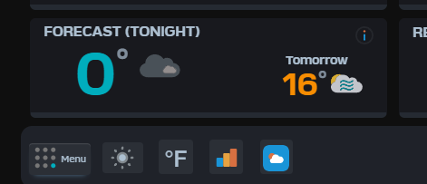

To fix the message “N/A” if 0 Grad, I changed the weather34-forecast-tablet.php file, works for me.

Re: Weather34 Aurora MKII Version 2022
good afternoon sorry for delay
simple update file via https://weather34.com
* (March 17th) * Fix N/A forecast at 0C/32F ref Lorenzo (Forum)
