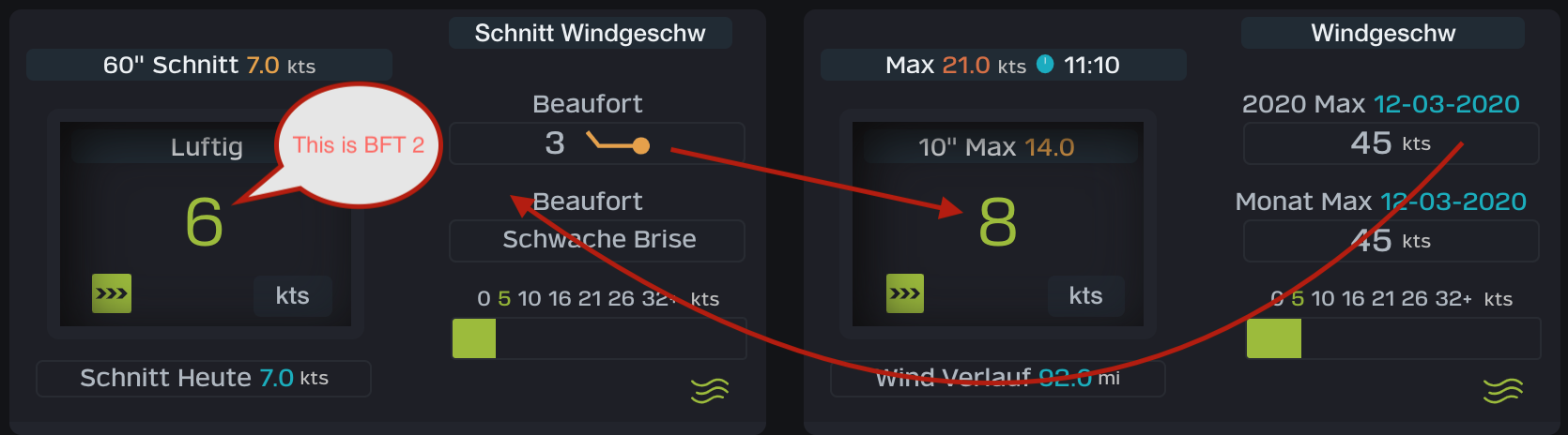

Edit: i have found another little issue:
The left field represents the average wind speed, right? But the Beaufort value displayed is linked to the current wind speed, not to the average wind speed displayed in the field. So the BFT value should probably be in the field of the current wind speed and the max-value texts from the current wind field in the average wind field. Simply said: exactly the other way round as current... ;-)

been raised before a few times but template uses the direct string from meteobridge output position 12 in the api output [wind0wind-act=bft.0:--] . no formulas or manipulation in template for Beaufort readings . in livedata.php you will see $weather["wind_speed_bft"] = $meteobridgeapi[12];
perhaps in the future move the bft output to windspeed but needs some thought as not to congest and cram the info into small areas otherwise it all becomes a mess. lets look at this in the future ...
the value in the larger box is an average wind speed reading not actual
Brian
weatherist34 wrote: Mon Mar 16, 2020 2:49 pm been raised before a few times but template uses the direct string from meteobridge output position 12 in the api output [wind0wind-act=bft.0:--] . no formulas or manipulation in template for Beaufort readings . in livedata.php you will see $weather["wind_speed_bft"] = $meteobridgeapi[12];
bft is actual
Brian

Hello Brian,
Hello, Brian,
OK; there is of course no easy manipulation possible if the BFT value comes directly from the Meteobridge... :|
The only possibility seems to be to calculate the BFT value directly in the template from the average wind speed. If you do it so, you first need a formula for calculation...
I don't know if this might help in the future, I have a javascript (works with WSWIN-Weatherstation-Program) for the conversion.
var wind = %avg10minwindg% (its the variable in WSWIN, might be replaced with ["wind_speed_avg15"] = $meteobridgeapi[72]? but I seem the Meteobridge-output is in m/s?
Wind data here in m/s:
var bft = 0
var txt =" bft"
if (wind > 0.28 && wind < 1.67){bft=1;}
if (wind > 1.66 && wind < 3.33){bft=2;}
if (wind > 3.32 && wind < 5.56){bft=3;}
if (wind > 5.55 && wind < 8.06){bft=4;}
if (wind > 8.05 && wind < 10.83){bft=5;}
if (wind > 10.82 && wind < 13.89){bft=6;}
if (wind > 13.88 && wind < 17.22){bft=7;}
if (wind > 17.21 && wind < 20.83){bft=8;}
if (wind > 20.82 && wind < 24.72){bft=9;}
if (wind > 24.71 && wind < 28.61){bft=10;}
if (wind > 28.60 && wind < 32.78){bft=11;}
if (wind > 32.77){bft=12;}
if (wind == 0) {document.write('silence')}
if (wind > 0) {document.write(bft)}
if (wind > 0) {document.write(txt)}
Maybe you can adapt something like this to php at some point in the livedata.php. :-)
I already thought that it is a space problem to put the BFT value into the current wind field.
Thanks for your explanations! Thank you very much for the very fast reaction time and for your excellent work in offering this possibility of weather data display.

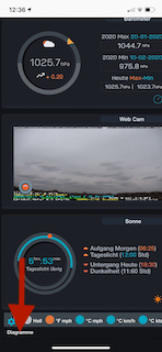

Hello brian, how do I call up the charts in the mobile phone version?
The button is removed with the new switch C/kts...

ToTo wrote: Tue Mar 17, 2020 1:12 pm Hello brian, how do I call up the charts in the mobile phone version?
i am not Brian but the button is now here:
regards
Mike

Hallo Mike,

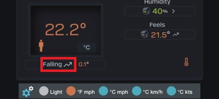

not on my iPhone 8. A small error is also the arrow that shows above, although the text says falling.

Okay, so I guess Brian has to look.
I am surprised that it is different with you than with me, I would not have expected that now.
(iPhone 10XR and iPad Air II)

please note this project is now archived on GITHUB until some normality returns ..
compromises were made to cater for languages extra metrics and so on , the chart display and forecast are now accessed via icons .having the option of F,C,kts,mph,kmh,ms ,charts,almanac,forecast,forecast summary just simply is not possible in all screen devices so the almanac,charts, forecast,forecast summary are icons . as per screenshot.
best I can do for now .

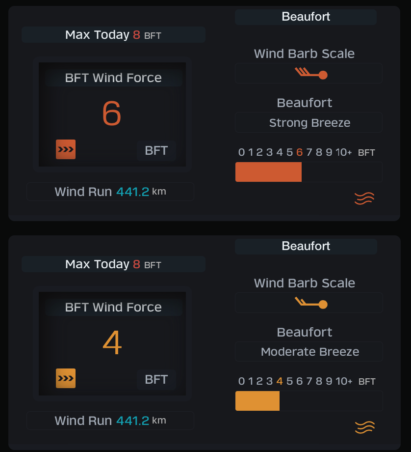

an idea but need it is of interest to anyone to use as opposed to wind speed average module ?
does this work ? a color coded Beaufort module replaces wind speed average module ..please let me know if possible before Sunday 29TH March..
allow time to translate a few words.. i.e wind barb scale
if not ill leave as is ..

Nice that there is something new again :-)
The Beaufort module shows the current wind speed or the average? I prefer the current one.
Wind Run is already used with the wind speed module, I might still have an average wind speed at that position.

no planned updates for the nanosd version anymore so this option wont affect you or others using that version its just an idea and i prefer it being in a rather predominant wind location where calm days are rare . ps windrun is moved into beaufort module when used and shows daily average in wind speed module . but as above option will be in standalone version only.
