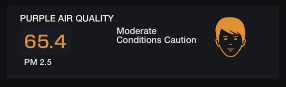

i have a PurpleAir sensor in operation I have recorded the device ID but no report displayed on the block ?
an idea ??
thanks in advance, have a nice day
best regards
fto
hello you can use the update simple file or just replace the weather34-airquality.php file
http://www.mediafire.com/file/css9rkizv ... 0.zip/file
just tested with your PA ID 40453

:D thx Brian just perfect ! best regards fto

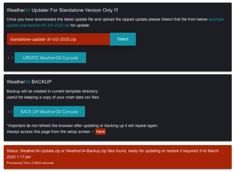

to setup Standalone Version 4.34 with 4 simple methods required to be set in the meteobridge services scroll down
its that easy to be up and running . 4 simple steps .
you can also apply future updates/fixes using the updater in the bottom of the setup screen once installed full download . no need to go through setup and reinstall each time.
the updater just simply is a zip that is required to be uploaded to your server where template resides . the updater will find the relevant update file
all small update files are dated example current small update is named standalone-update-31-03-2020.zip
bonus make regular backups prior to updating or preserve your chart data for later use/transfer etc
full downloads always contain the latest updates/fixes

When I used the update function in setup selecting the standalone-update-31-03-2020.zip file 3 files did not update so I copied them over manually. After manual copy the Almanac is fixed.
weather34-updater, weather34-airquality, and updater-almanac
Thank You!
73s
..Ron
that doesnt make sense as the update file has more than 3 files , just tested here and everything updated as expected .. feel a server headache coming on :D .. can only test locally or on ICDsoft hosted server. 2 large amber nectars please .. :shock: :shock:
