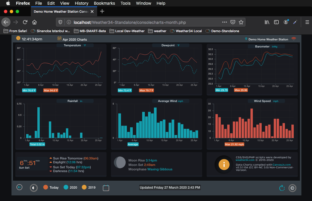

I did the update, on chrome it works correctly but on Firefox not, the max values are not aligned but scattered.
https://stazione.meteosantangelo.it/consolecharts.php
thanks just pushed an update ..interesting how Firefox is beginning to be different to webkit browsers like safari,chrome etc .
screenshot of Firefox just now.

I noticed the Firefox thing yesterday but all is looking good on my ipad and W10 now.

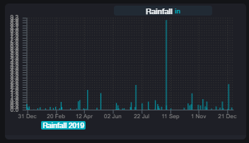

Everything is looking good on all the browsers that I tried. I have one minor 2019 rain chart scaling issue (inches), but I think it may be because of the extremes during 2019. You can see it below. Not a big deal.
Take care,
Your update fixed the 2019 scale!

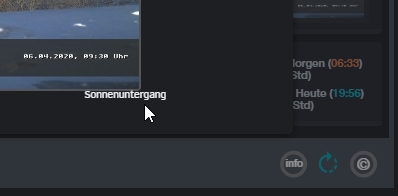

Good morning,
i get an overlapping text "Sonnenuntergang" from sunmod module, when I open the webcam, info or template info window:

ToTo wrote: Mon Apr 06, 2020 10:00 am Good morning,
Would it be possible to include a switching of the console language in the interface?
Good afternoon Toto
I have adjusted the css to remove the overlap (z-index) . as for languages needs a lot of rewriting and some thought how to offer that not something Im planning on in the near future . but lets look at it at a later date as the only thought needs to be how to offer in terms of display without congesting the rest of the appearance.
Posts: 259
Thanks it is fixed.

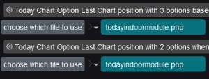

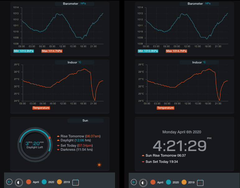

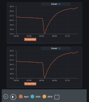

Would it still be possible to add another module e.g. for indoor humidity chart? Because I have no UV or solar sensor and the only alternative is to view the indoor temperature twice in the smartphone chart.
Toto not at the moment not doing any new additional modules but we can implement some existing modules as a replacement for those not having uv or solar .
I added two option to the setup screen as a short term fix for you best I can do for now.
as in previous post I have allocated my desktop Mac to wife for the foreseeable future which I do or did most design work on. I don't find using a laptop screen very productive and don't have all the software I have on my desktop on my laptop to do some of the finer design code.So for now I am not doing anything apart from what is reasonably quick or manageable(simple) on a laptop.
screenshot of the extra option you can choose sun or clock
