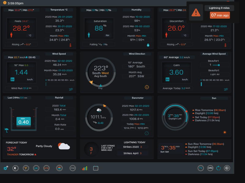

The strike icon is a nice addition! Had a storm last evening and it worked great. I may need to shorten update frequency a little.
Have a great day.
I set mine to 1 minute upload interval
forgot to say I added the alert notification to the lightning module only appears if strike(s) within last 10 minutes
Yes, I saw that addition on the Github update. That's when I thought I needed to lower the interval. Just switched to 1 minute.
Thanks again

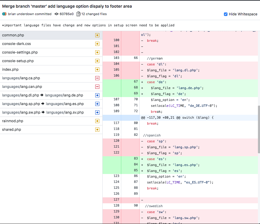

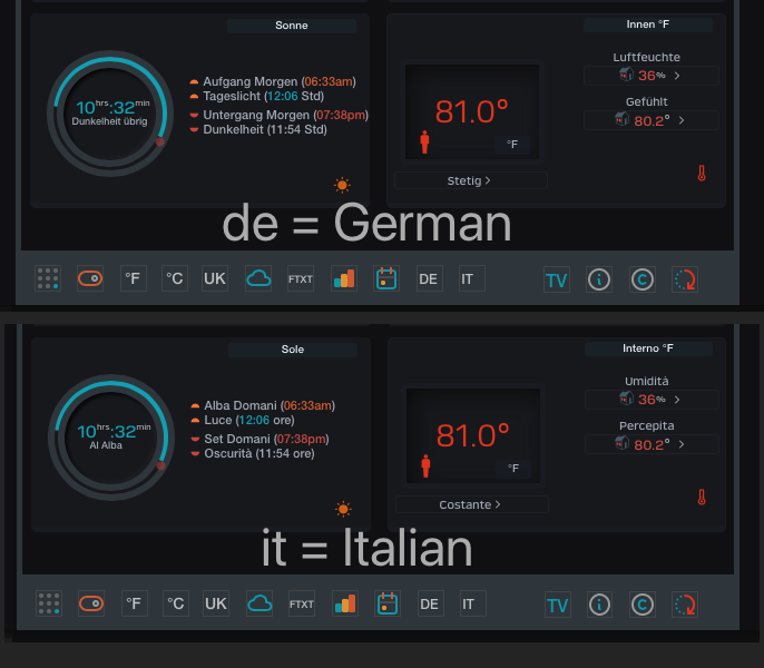

after some thought and not simply saying NO to your request without getting sucked into creating a congested design I added an option to display second preferred language
or disable the language option icon display in the footer area. adding all language icons just congests the whole area and really screws up the mobile view .
it is important to apply the new settings in the setup screen and all unused language files and code have been removed . All language icons are based on International ISO code abbreviation so it is important to note the way language file are now handled in this way i.e
for your language German it is no longer DL it is DE .
I hope that is somewhat useful and best I can do to avoid the practice of too much information which basically messes up design UI and it is easy to manage from development point of view. keep it clean , keep it simple and it is easy to use :-)

Brian, Thank you very much for the language switching option!
Unfortunately, switching between the two languages does not work for me, it always remains the default language.
just checked demo its working for me switches between de to en and vice versa based on setting de as default language. might want to check you updated all files ?? there was a considerable change to have this option.

weatherist34 wrote: Tue Apr 07, 2020 3:01 pm forgot to say I added the alert notification to the lightning module only appears if strike(s) within last 10 minutes
Wanted to let you know that the Lightning Module is working great. Had a storm last evening and 45 strikes rolled in and the Alert worked fine!
