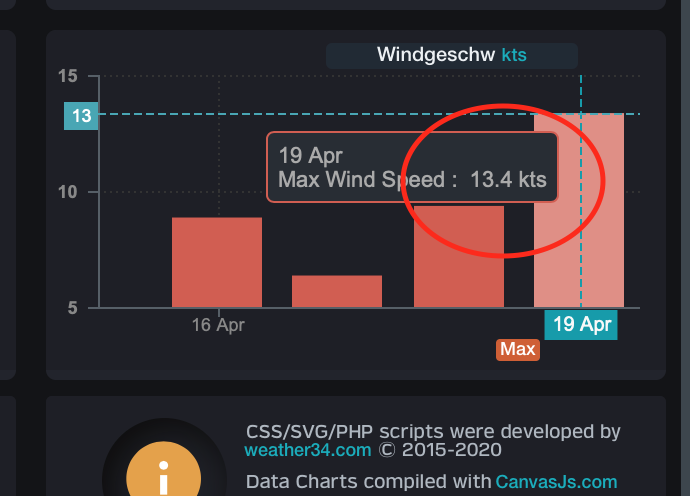

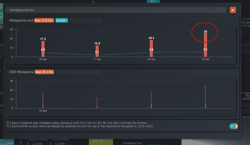

I think I found a small error in the graphic display of the month in the wind maxima.
I use the MBSMART template with the nano SD display and the integrated console display. With the nano SD graphic display the monthly max wind values are displayed correctly, but with the console display they are too low:
Console-Screen with wrong wind-max
Bildschirmfoto 2020-04-20 um 21.40.33.png (64.72 KiB) Viewed 4792 times
MBSMART-Screen with correct wind-max
Bildschirmfoto 2020-04-20 um 21.39.37.png (300.73 KiB) Viewed 4792 times
Is there still a way to correct this or is it not possible because the MBSMART template does not actually receive any more updates and my console-screen is a part of the MBSMART-Template? I would like to have both possibilities to view the weather-data...

good morning no problem
the link below contains 6 files .
monthwindspeedmodulechart2.php
monthavgwindspeedmodulechart2.php
yearwindspeedmodulechart2019.php
yearwindspeedmodulechart2.php
yearavgwindspeedmodulechart2019.php
yearavgwindspeedmodulechart2.php
basically adds the missing conversion
else if ($windunit == 'kts') {$conv= '1.94384';}
download
unzip on desktop
upload to server into the console/weathercharts folder job done.
http://www.mediafire.com/file/al6hqoapt ... x.zip/file
Brian
xray77
Posts: 184
Post by xray77 »
Hello Brian,
Many thanks for this superfix little update, great support! Works perfect now!
Have a nice day and stay healthy!
Best regards
Mike
