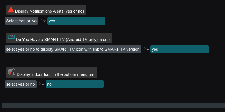

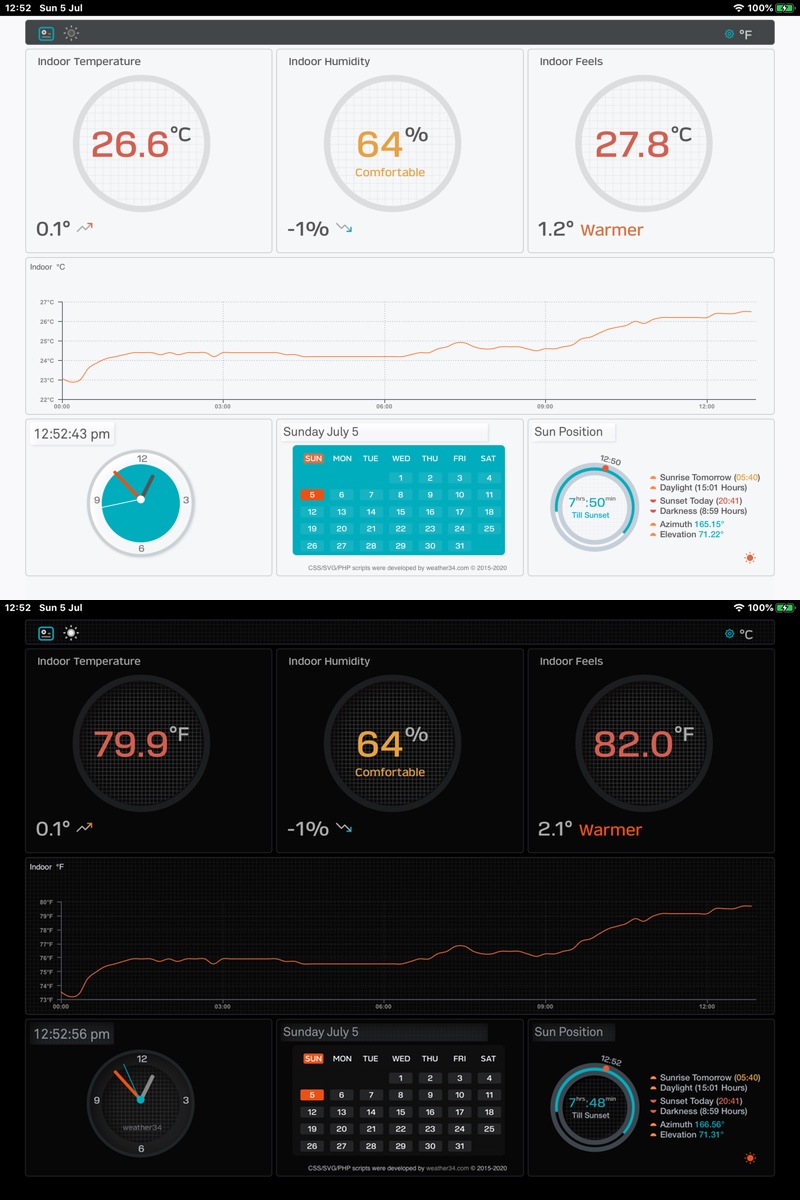

update 5-7-2020 (117kb) Standalone-update-05-07-2020.zip
adds theme dark/light switching to indoor screen + adds new setup option to hide indoor icon if no data available or wish not to use

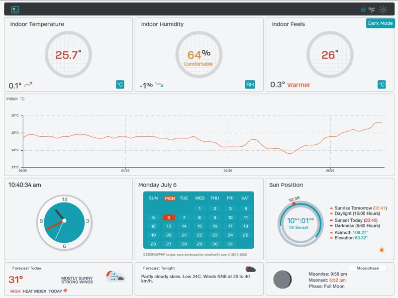

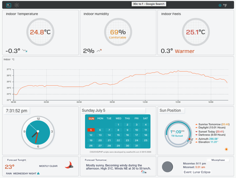

good to hear things are slowly returning to some normality but as ever be cautious ..so last update just pushed just now to the indoor screen addition with a few additional bottom modules to balance it all out.applied to both dark/light themes .
have a great weekend whats left of it...Brian
Re: Weather34 TEMPLATE
Till next time have a great week ahead time for me to head to the airport.. last minute clean up of code for the newer indoor addition with blue styled hover tips when hovering over functions/links and it should resemble the screenshot as of 6th July ..have fun and thanks for the feedback..
