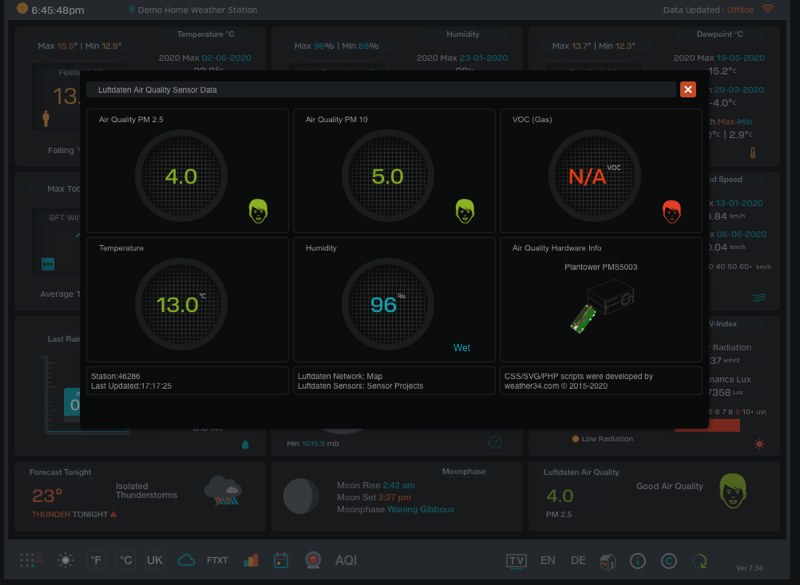

added new option to choose luftdaten sensor if you send data to them .

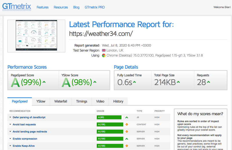

@chuck did you receive the email from ICDSOFT about PHP-FPM-enabled servers definitely choose this option when it appears in your panel under php settings .see below first time ive seen under 1 second !! always averaged 1s to to 1.8 seconds to go sub 1 second is impressive !

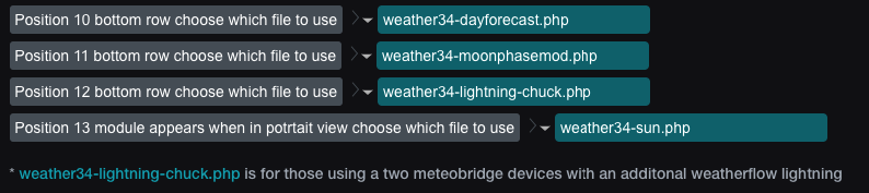

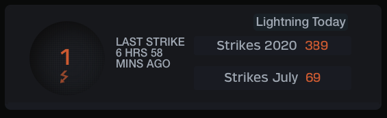

chuck your lightning file is now called weather34-lightning-chuck.php and has a new option in setup screen. the weather34-lightning.php is for those using a new weatherflow TEMPEST all in one for all their data .Last week or so more weatherflow Tempest users appearing so being that the weatherflow tempest is an all in one solution when used with a meteobridge I have aligned the lightning option and renamed your one off file to weather34-lightning-chuck.php.
so there are two options now for lightning .one with tempest as station and one for those that use an additional meteobridge with older weatherflow type AIR .

Thanks for the info - I made the lightning change. I did notice that the "chuck" selection is available for Module 10 and 12, but not 11 in the setup file. I added it is an option for module 11 in mine. No big deal - just thought I would let you know.

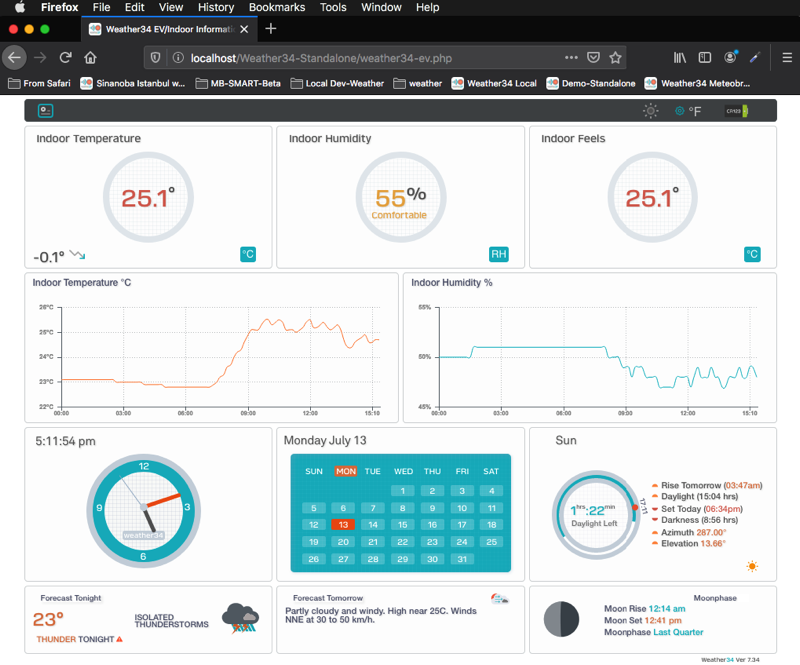

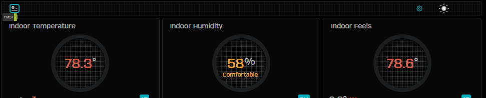

I've included a screen shot of where the new battery indicator for the indoor screen shows up using Firefox & Chrome under Windows.
All OK using Ipad's Firefox and Safari.

Correction .. Under Chrome in Windows all OK .. it's only Firefox ..
Posts: 1841
Re: Weather34 TEMPLATE
hi Ron unfortunately I don't own anything windows but was able to see that in firefox Mac .. try the update just pushed..many thanks

All looks Good in Windows Firefox.

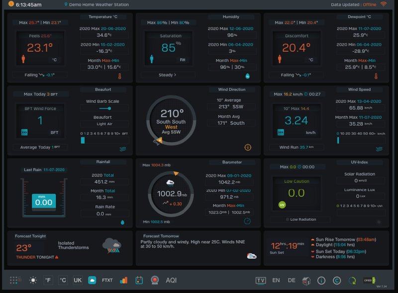

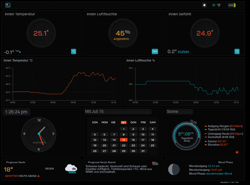

I would like the module for tomorrow's weather forecast from the indoor mode, also as a module for the position 10-12 of the console?
Posts: 1841

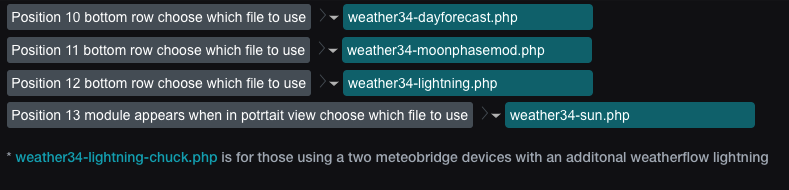

hello all added , I think this is what you were asking if not please provide some visual idea if possible .
selectable option in positions 10,11,12
simply run the updater (375kb) Standalone-update-15-07-2020.zip file available via https://weather34.com/homeweatherstation/

sincere apologies but seeing your site in German reminded me to add the language support to the indoor screen . just updated the standalone quick update file.
