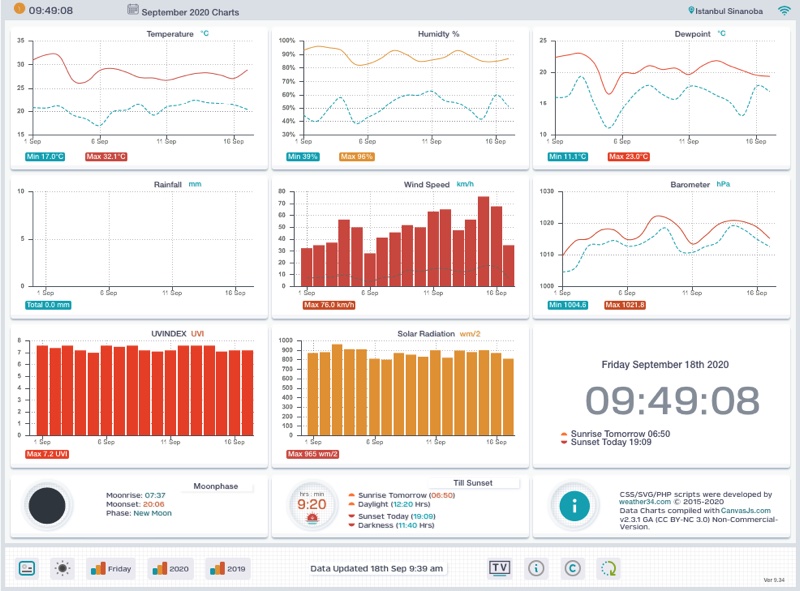

Just noticed an odd thing with my September and 2020 Barometer Chart. I thought it might be a bad data point, but Ron's site is showing the same issue.
Here is a section of the 2020 data file.
Charts end of Day file that was updated yesterday?

hmm this is why avoided meddling with the chart data for so long , what you will have todo unfortunately is edit/delete the line beggining/from 17 Sep .
I have pushed a fix but its a case of waiting till end of day to see if it works for you. failing this I will simply just revert back to original end of day charts file .sincerely apologize but been pestered for this feature for months and try to avoid it knowing full well how it can mess up If I get it wrong and I did . sometimes if aint broke don't fix it is too true..

No problem. I am assuming the last line should be 16 Sep data.

I have the files and it's all fixed. I saw the new data points that were added. Charts look fine now! :D

ok I just ran it on your server from here it worked as expected :-) you will need to just delete or reupload the two files I sent via email earlier.
below show the new values of max UV and max Solar
16 Sep,26.0,19.4,23.4,16.7,15.2,10.1,1.0,24.0,1019.3,1014.1,6.2,816.0
16 Sep,26.3,24.0,25.0,22.7,6.1,9.4,0.3,26.0,1014.5,1008.9,1.9,272.0 .
so at midnight it should do as expected . theoretically :-)
I will release and update for all in the morning ..once again thanks for your help..Brian

good morning i released a critical fix in the simple update file 18-09-2020 . big thanks to chuck for choosing GITHUB it really does provide a good platform for eradicating and finding problems quick.
if you have a broken month, year chart which is most likely if you ran the update 17-09-2020 please contact me via email i will happily fix your charts .
sincere apologies for the inconvenience.
update this morning gives the option for those who own a uv sensor , solar sensor to have month and year charts for these two sensors .
Brian
Re: Weather34 TEMPLATE
Looks like everything is working fine :D
