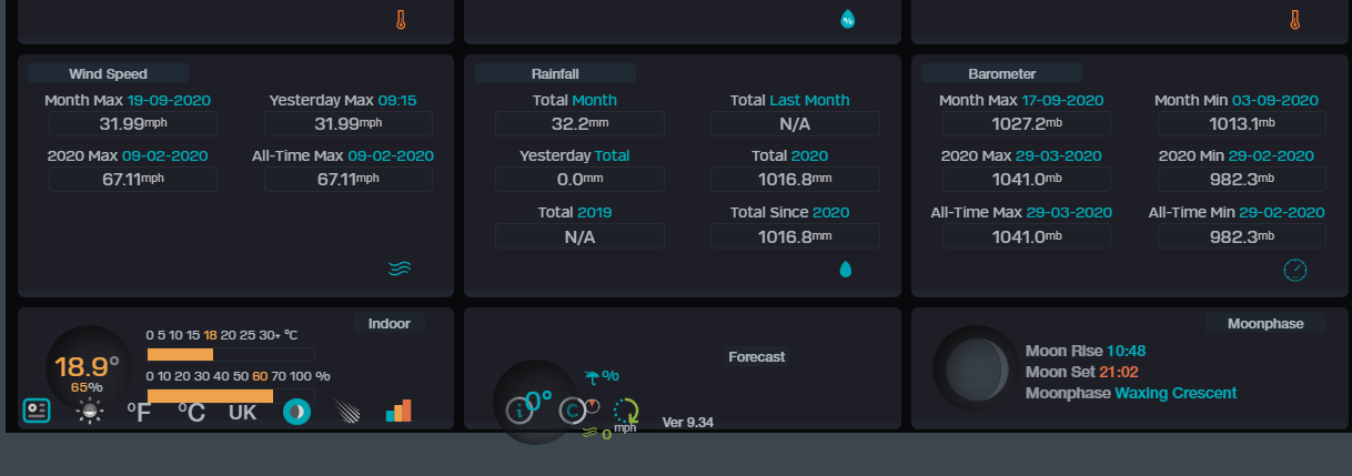

Hi Brian with the latest up date i am seeing a small problem with the bottom row merging together
Regards Richard
Regards Richard
- Dashboard 2.png (334.69 KiB) Viewed 4586 times
- Posts: 1841
Re: Weather34 TEMPLATE
hi richard ill take a look probably missed something stupidly as usual , think im getting to old and senile for this
- Posts: 1841
Hello Richard I didn't account for user not having a UV SENSOR , please just download the update file again and run it should resolve the almanac alignment .

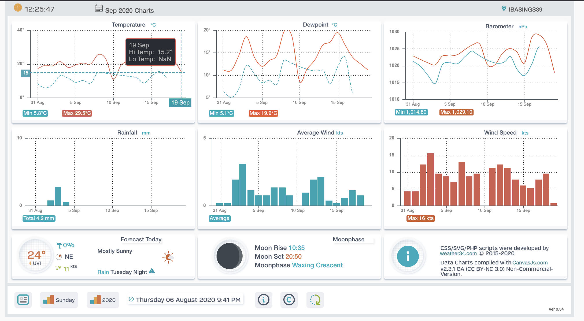

Something amiss with the charts. Lo (min) temperatures, humidity, dewpoint & pressure are missing (NaN) for yesterday (19th) in monthly charts. Lo (min) values for the 18th are there but are not displaying on the graph lines. Any thoughts? September.csv is below:
I think I can find and fill the missing data from submitted Wunderground data.
31 Aug,17.1,8.4,11.2,6.4,0.0,2.2,0.1,9.1,1023.0,1021.4

18 Sep,21.7,9.1,12.6,7.9,0.0,4.9,0.4,13.5,1026.1,1019.3,--,--
19 Sep,15.2,--,11.2,--,0.0,0.4,--,15.8,1018.0,--,--,--I think I can find and fill the missing data from submitted Wunderground data.

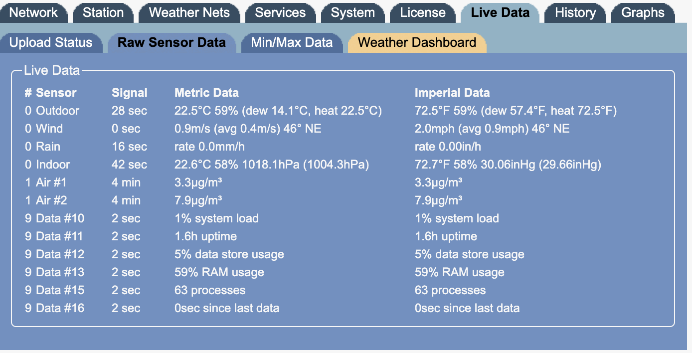

I now have my user defined script recording PM2.5 and PM10 values via the NanoSD. However this is not showing up in the airqualitydavismod.php I was hoping that the work done on the user defined script would do the job of writing to api_181 and api_182. Alas, no!
Ps. I used the following code (in a copy of livedata.php) to dump out the contents of the incoming api 181 and 182 are definitely blank.
output:

Brian, understood. Without a unit it's difficult to fully experiment.
I have air1!1pm and air1!2pm values being recorded on the NanoSD using the User-Defined additional weather station rather than my workaround (SDS011 via RPi) until I get my Airlink. I was hoping that these were outputted by the NanoSD in the Weather34 weather station template as meteobridgeAPI_181 and meteobridgeAPI_182 fields; but they are not.
Boris has helped loads to get this far and I'm sure we'll get to the bottom of the problem, but thats for next week!

I'm not looking to add more string into the API. I've seen all your recent posts and know that it's full.
I'm really trying to use the NanoSD User-defined weather station option (a script) to emulate the collection of AQI 2.5/10 Airlink data while I wait a month or two for my proper Airlink to arrive.
If I'm reading Boris's release notes correctly, a user-defined weather station is just a script pretending to be a weather station. If it's the first additional station then instead of th0temp, th0hum, th0dew etc. the raw data collected will be th1temp, th1hum, th1dew etc. In the case of air quality, my additional station is collecting data thus air1!1pm, air1!2pm.
I'm assuming that an Airlink, when added as the first additional station, will collect raw data as: th1temp, th1dew, air1!0pm, air1!1pm, air1!2pm etc.
I can only assume from my lack of success that the Airlink values as recorded on the Meteobridge are not conforming in some way to my expectations and the documentation.
