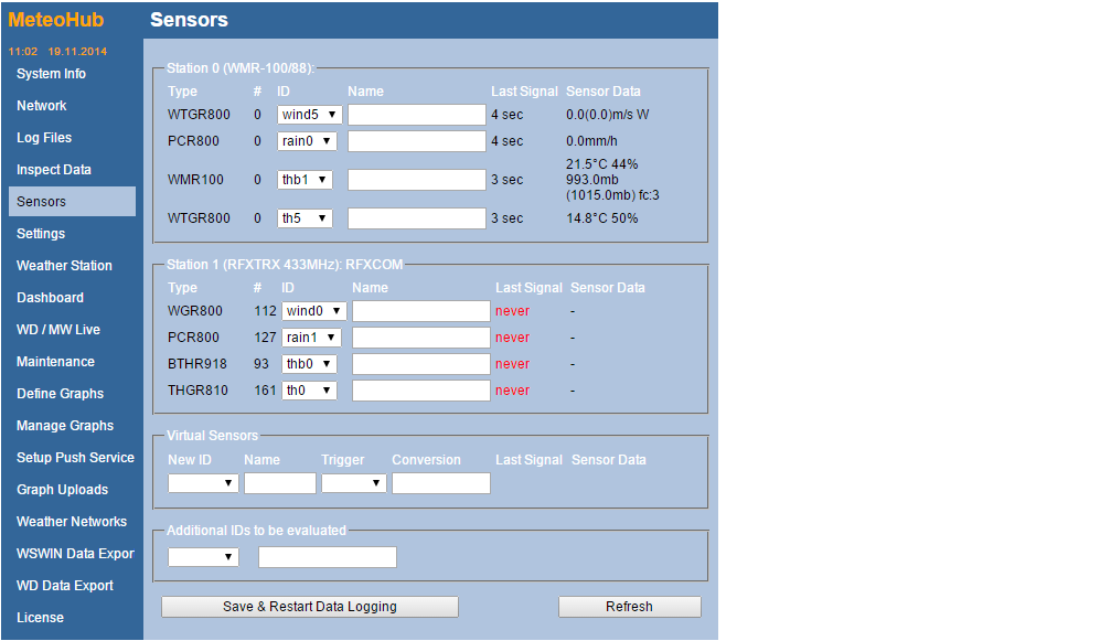

And that after reboot capture data WMR100 and not RFXCOM ?
JM.
