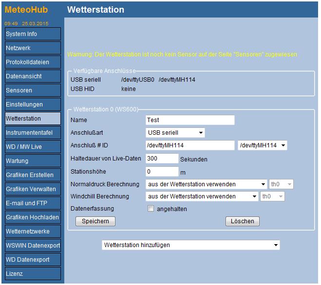

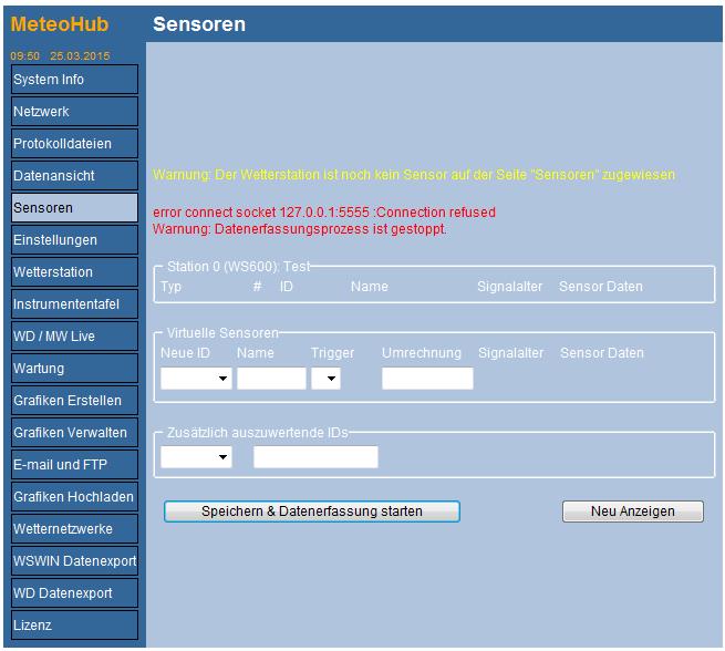

So i have tried to connect the station but there occurres an error. I have added the screenshots in the attachments.
In Meteohub i have not found the settings of the baudrate.
- Setting of the sensors
- Sensors.jpg (53.79 KiB) Viewed 19066 times
- Settings of the Weatherstation
- Weatherstation.jpg (62.12 KiB) Viewed 19066 times
Re: Weatherstation Lufft WS600
What does "Log Files" say? Section "meteohub log" should show reports form the data logger.
It is always a good idea to inspect log files, when something doesn't work...
The following Information is available in the meteohub protocol:
2015.03.26 13:49:10 log file cleared by user
hwclock: Cannot access the Hardware Clock via any known method.
hwclock: Use the --debug option to see the details of our search for an access method.
logger (01.01.1970 01:00:22): System date not properly set. Please set date and time correctly before data logging can start.
wmr928fulleval(26.03.2015 13:50:59): recomputation of weather data started.
wmr928fulleval(26.03.2015 13:51:00): recomputation of weather data finished: 0 records processed in 0 seconds ( records per second)
logger (26.03.2015 13:51:18): data logger (version 5.0f, build 69) started.
logger (26.03.2015 13:51:19): connect station 0 (WS600 via USB serial).
But on the top of every page there is a warning that no sensor is connected “Warnung: Der Wetterstation ist noch kein Sensor auf der Seite "Sensoren" zugewiesen”.
So I tried to create a new virtual sensor (I don`t know if this is required) and now these information is available in the meteohub protocol:

logger (26.03.2015 14:11:53): data logger stopped.
logger (26.03.2015 14:11:53): data logger (version 5.0f, build 69) started.
logger (26.03.2015 14:11:55): connect station 0 (WS600 via USB serial).
logger (26.03.2015 14:17:25): child process received timeout signal (14).
logger (26.03.2015 14:17:25): disconnect station 0 (WS600): exit
logger (26.03.2015 14:17:26): data logger stopped.
logger (26.03.2015 14:17:26): data logger (version 5.0f, build 69) started.
logger (26.03.2015 14:17:27): connect station 0 (WS600 via USB serial).
logger (26.03.2015 14:22:57): child process received timeout signal (14).
logger (26.03.2015 14:22:57): disconnect station 0 (WS600): exit
logger (26.03.2015 14:22:58): data logger stopped.
logger (26.03.2015 14:22:58): data logger (version 5.0f, build 69) started.
logger (26.03.2015 14:22:59): connect station 0 (WS600 via USB serial).
To what ID is your UMB configured? These systems are not plug and play.
Did you connect it for testing and configuration with your PC? Does it work there?
Looking at the code I think that it is the binary format... sorry.admin wrote:when I remember correctly the ASCII one.
Thank you the protocol was the only problem!
