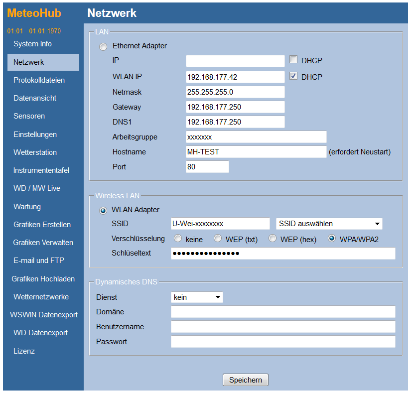

Edimax EW7811Un works absolutely flawless in my meteohub (5.0i) / Pi2
Of course you have to setup MH first on wired connection, only after all things running well you will switch over to WLAN.
sorry for german picture version...
BR Peter

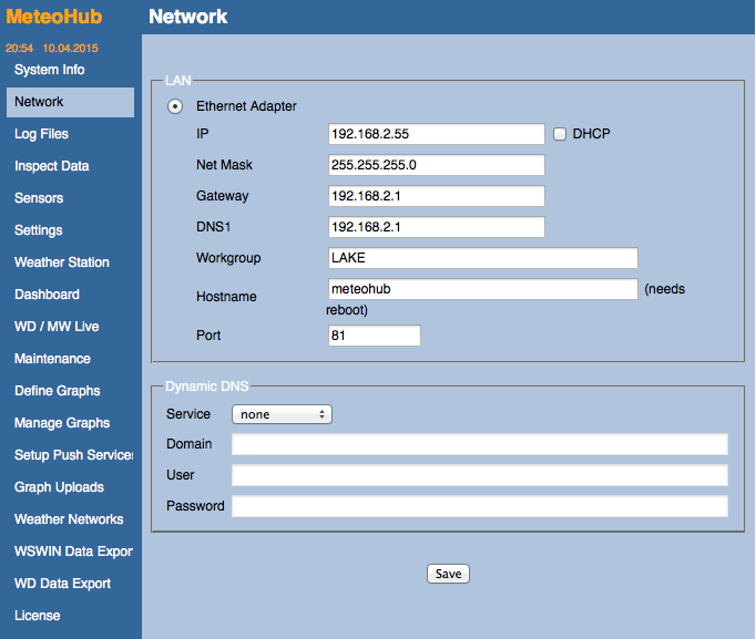

I am also running 5.0i on a RPi 2, but my network page does not show the WLAN part. Is that something that appears when you install the usb WLAN adapter?
Thanks for the info on the Edimax adapter.
peteroi
Posts: 51
Joined: Thu Jan 31, 2008 2:26 pm
Location: Dietenheim / South Germany
Re: Pi 2, wifi and MeteoHub
Post by peteroi »
Yes, this page only appears after installation of an wlan adapter and successful recognition by Linux.
Safest method is power down MH, install adapter, power up.
If no adapters appears on setup page then it is an adapter which is not known to Linux, and you need very probably some special drivers...
