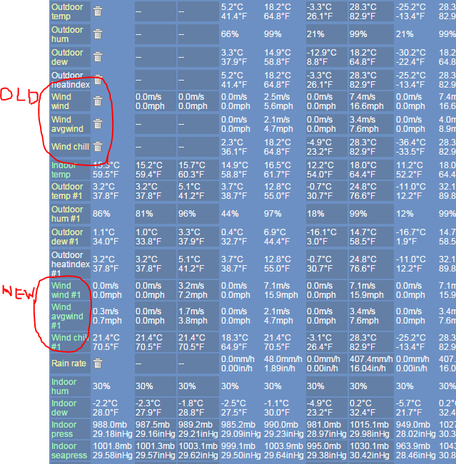

Hi
I have been using the MB with an Acurite 5in1.
Everything has been working well with sending data to WU and CWOP for around 4 months.
Recently i acquired another few sensors. I got another 5in1 and it was seen by the Acurite bridge and the MB. it llabelled it
Wind #1 as the new 5in1 and the old 5in1 was kept as "Wind". see above.
I have been able to reconfigure the data sent to WU from the new sensor sending only the rainfall data and wind speed data.
However I recently noticed that the wind direction data was coming from the "old" 5in1 sensor. Somehow there is no option to choose the new 5in1 sensor as the one to send this data from. Is there someway to change this?

As it is green, it is selected as primary. Your observation is that wind direction is coming from the old sensor,
but speed is coming from the new ones?

Yes that is correct.. Your software appears to keep the sensors that have been registered by the bridge.
Even if they are disconnected and have the batteries taken out of them, MB remembers them and starts keeping data on them once they show up again.
I noticed that WU had a constant reading for the wind direction. I had the original 5in1 inside but still had the batteries in, so I changed the vane position and WU responded with a change in the position... These are readings from the "original" sensor. I then removed the batteries... WU now says that I am not sending wind information to them... they still acknowledge that wind speed is sent (from the new 5in1 sensor - shown in green) However no changes to the direction! Even though the "new" sensor in green is the "primary" sensor, MB still is sending null info from the "old" 5in1!

Checked code and you are right. Sensor for wind direction is not changed. Next update will change wind direction sensor when primary windXwind sensor is changed.

Thanks I have had one go at changing the settings.
Since there is no actual green setting for wind direction I changed from the "wind" the the "wind #1" as my primary wind sensor.
I did not block the "wind" one, I just changed to the new "wind wind #1". It did not go green. I then changed the "wind avgwind #1" to the primary sensor. It changed to green. I then changed the "wind windchill #1" to the primary and it too changed to green. However no data was sent out and WU shows no data being sent.
I then tried to change back to the "wind wind0" as the primary but it was not accepted. The other "wind avgwind0" was accepted a green and the "wind chill" also reverted to green but WU still is getting erroneous readings.. like speed of 198km/hr. and multiple directions. I will likely soon be dropped by WU for inaccurate data.
