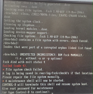

My card seems to have problem with the code : "failed (code 4)".
When I read the cf card with an explorer I have a lot of files.
Where I could find all my data and my MeteoHub setup ? How to repair ?
thank you

Please connect a keyboard and let operation go on via "cntrl D"

Yes, it is working with ctrl D but how I could fix this problem ?
Re: code 4 Cf card crashed
Please login to secure shell (as offered in the screen dump) and do a manual "fsck" run (also as recommended in the screen dump).
