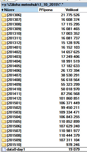

The sheevaplug write to log, that memory is full. Due to I checked the saved data, and I see, that in last time data are so big (see picture)

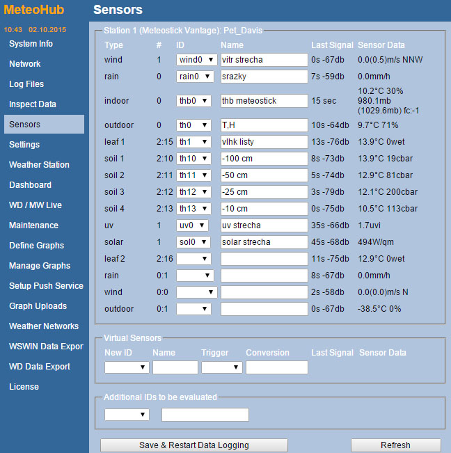

In 07/2014 I added meteostick and davis uv, solar.
In 08/2014 I added 4x temp, 4x soil, 1 leaf.
In 10/2014 I canceled wmr200 sensors (tem, hum, wind, uv) and I replaced sensors with david sensors (no additional sensor, replace part by part).

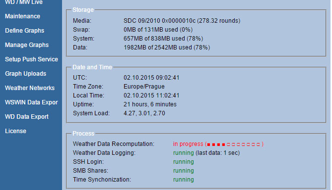

I deleted old data (before I backed it to the pc). Than I used the recompute, but after 21 hours the still compute data (see picture)

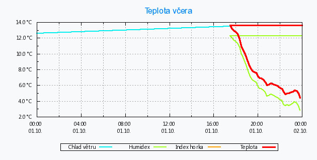

And in uploaded the charts is a lot of errors

- More sensors will generate more data
- While the recomputaion is runnning, the graphs won't be correct, as they relay on aggregate data (that is generated during the recomputation)
- Yes, recompute will take a long time on a Sheeva. More data, implies longer runtimes
- Yes, you can increase the size of the /data directory, but I'm not sure if it is a good idea, as it will imply that your Sheeva will need to manage even more data.
