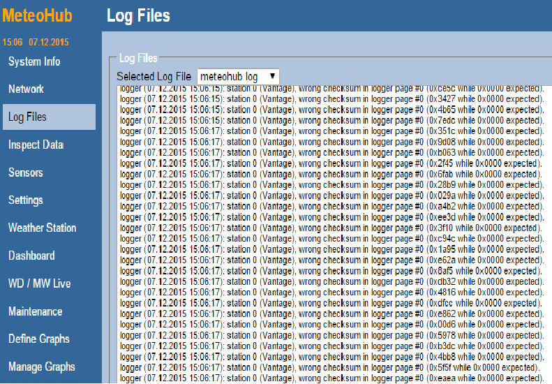

Everything works fine but has three days that has not Data on SENSORS Card
and log Card writes :
I did RESTART , start - stop Data Logging Process but nothing .

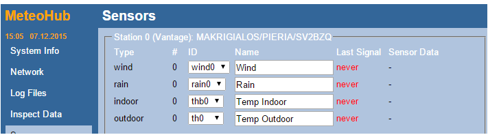

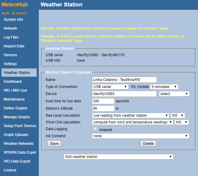

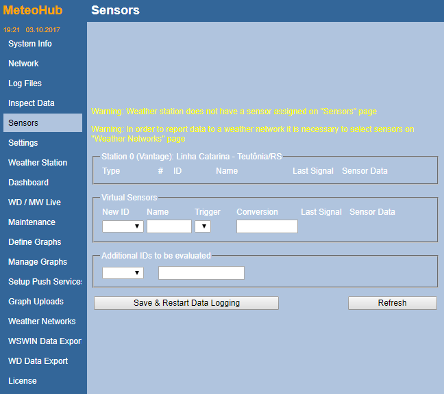

My case is a little bit different. Meteohub see that there's a station conected but no sensors are shown on sensors page.
Sem título-2.png (118.37 KiB) Viewed 5203 times
Sem título-1.png (95.54 KiB) Viewed 5203 times
My hardware is a Davis Vantage Pro 2 6162 + Belfryboy Clone USB logger + Raspberry Pi 3 Model B.

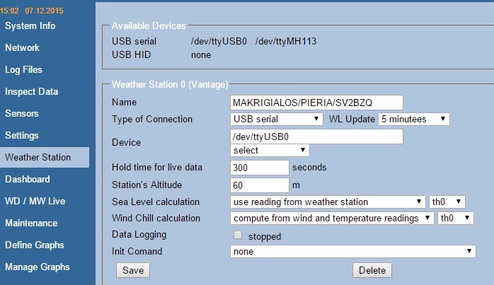

Re: Problem with Davis + Belfryboy Clone USB logger + Meteohub
Settings look ok. I guess the Davis Console has hung-up by a logger inserted during operation.
Power-cycle the console and data should come in fine again.
