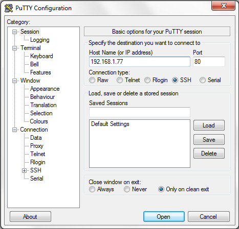

I am new at RPi and meteohub, I just installed it.
So I have not upload anything yet.
I try with putty, but no connection.
Am I doing right like the picture when I try to connect with putty?

I would recommend to use port 22 when using putty.
