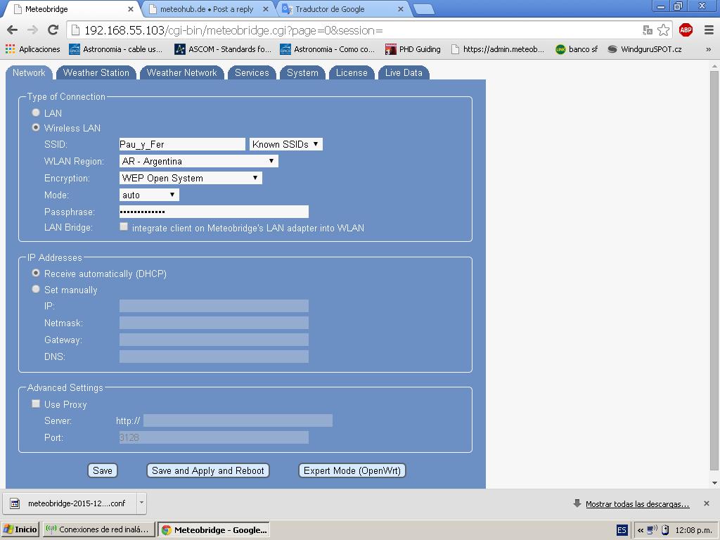

WLAN is configured, but the restart and remove the LAN cable is not connected to the router

Are you sure that your router uses WEP encryption? As WEP is very unsecure most WLANs make use of WPA.
fernando_haller
Posts: 14
Joined: Wed Dec 30, 2015 1:32 pm
Re: 3020 tp link, do not connect via WLAN
Post by fernando_haller »
the pen driver configure method, and it did not work, change of WEP and WPA connection does not work

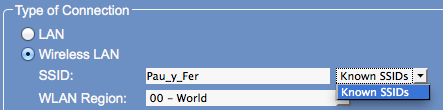

Thanks, I can login. My finding is that Meteobridge does not see any WLAN SSIDs.
Are you sure that it is a 2.4GHZ WLAN (b/g/n) and not a 5GHz (a) which is not
supported by the MR3020 hardware.
As you see, the drop-down with SSIDs to connect to is empty.
Screen Shot 2016-01-04 at 19.42.12.png (17.16 KiB) Viewed 9221 times
