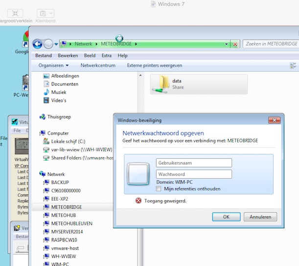

The Meteobridge-Pro is visible in aDAP wrote:I re-booted my Meteobridge Pro to play with the new ability to set the windows workgroup name.
Unfortunately, the Meteobridge Pro does not show up when I poke around my network looking for windows shares.
Is this feature just not finished yet? I'm hoping that this is intended to allow access to the weather data through a samba shared directory. I did not see any documentation yet though.
Windows-7 environment in the network box as METEOBRIDGE, clicking on it gives me the logon box
Mac environment in the finder as Meteobridge, clicking gives the data folder as guest, right clicking the logon box.
So it is there, screenshot attached, sorry for the Dutch language.
What windows version are you using?
Did the device show with a network scan program?
- win7.jpg (82.27 KiB) Viewed 2998 times
