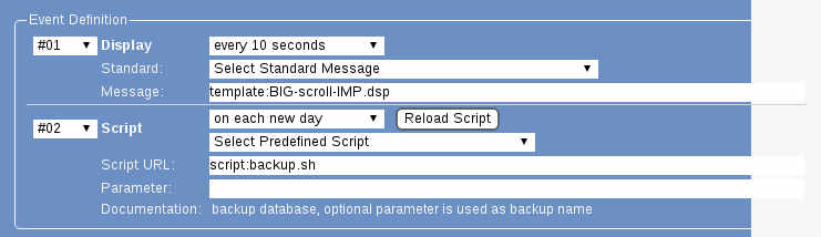

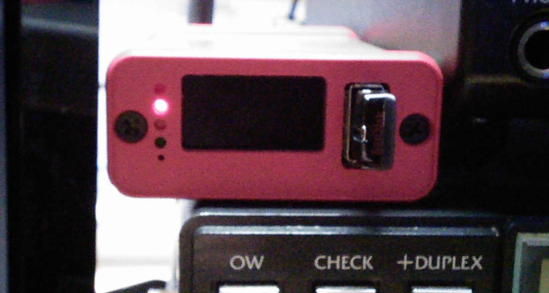

For an unknown reason my info display crashed/quit updating, stays blank like in the picture below.
Two picts attached, one of the blank display and one of the services tab:
Firmware build = 9199.
