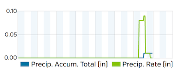

I've recently seen a discrepancy in the meteostick/bridge compared to my Vantage console and CoCo rain gauge. Tonight we had 0.09 in of rain, verified on the console and Coco at 0.09 in. Howeverm Meteobridge reported only 0.01 in total accumulation.
The enclosed Wunderground image for the time (just under an hour for the 0.08 - 0.09 rate) doesn't show the accumulation going up.

The graph does show the total rain figure going up by 0.01. That the rain rate is showing more is not a contradiction as rain rate is a prediction into the future what rainfall in next hour might be in total when rain intensity will stay as is.
