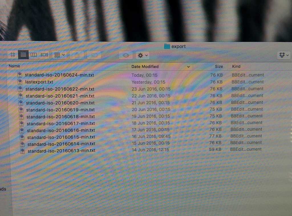

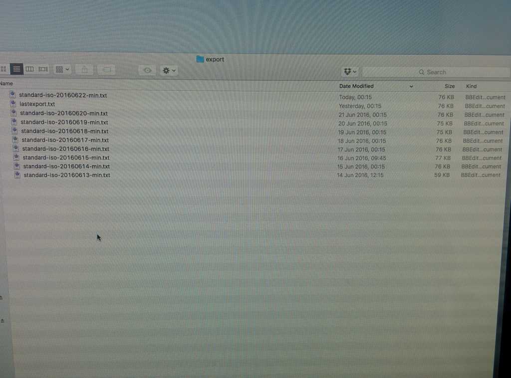

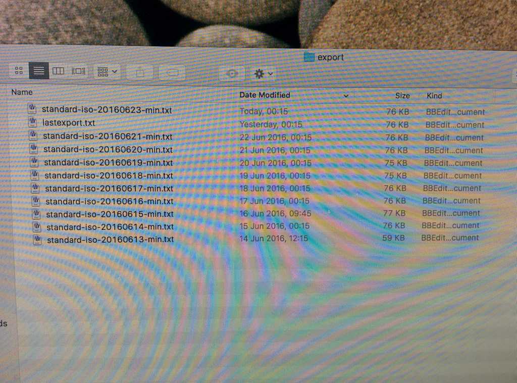

Actually,
I have been observing the "export" folder for several days now, and some weird behavior exists:
If you look at the first attached image (attached file: lastexport_1.jpg), notice how the file for the 21st of June is missing, and it has been replaced by lastexport.txt with the previous day's timestamp.
Then, the following day (see attached file lastexport_2.jpg), the file for the 21st of June re-appears, but this time the file for the 22nd has been replaced with lastexport.txt.
Finally, the pattern continues on the following day (see attached file lastexport_3.jpg). Note the "Date Modified" time stamps in all three attached images.
I apologise for the quality of the images, but I think one can still see the relevant information in each image.
Is this some kind of bug?

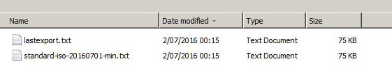

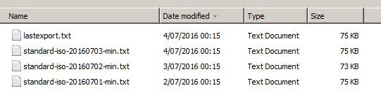

Re: Lastexport.txt file **solved**
Interim results for the first 3 days (max # attachments allowed) attached, no problems so far including 5/7/16.

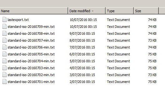

Results after 1 week, all good, all as expected and did not notice anything strange from day to day. Will keep the service going a little longer and will be back if there is anything strange.
