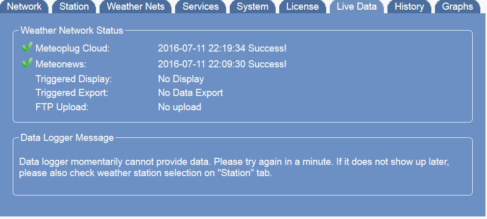

Ok not shure what it is, but on every reboot, the Display shows; "formate storage" after few second (about 45sec) it changes to: "format failed"
After that it shows the Local IP-adress and I can acces the MB-PRO over the browser.
But there are no Live Data anymore, this morning when i started this post at least i had the livedatas. so it seems to be getting worse.
I can't use the local share \\192.xxx.1.xxx\data, even if I create folders by my own, after every reboot the DATA folder ist empty I think cause of the format-process at startup. So that means there are no templates to load up via FTP or show/change the display info!
Thanks for help!
