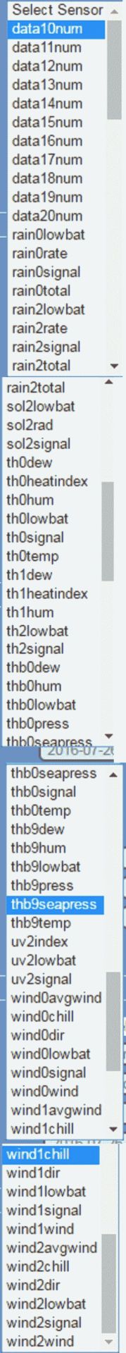

Can someone explain the multiple sensors available on my system?
I have a wireless Davis Vantage Pro2 Plus. The wind, solar and UV are located on a secondary wireless transmitter.
It seems like there are some unnecessary duplication of entries?
PLEASE -- Ignore the duplication due to four screenshots being pasted together (such as rain2total, thb0seapress, wind1chill)

Which "duplicates" are worrying you? Are there sensors listed twice?

There are Rain0 and Rain2 (4 different types)
Th0 and Th1 (3 types)
Th0 and Th2 (2 types)
Thb0 and Thb9 (6 types)
Wind0 and Wind2 (6 types)
Re: Sensor List
Idea behind sensor naming is that it consists of 3 parts:
  • sensor type: "th" stands for combined temperature and humidity sensor, ...
  • sensor id: first and primary outdoor sensor is labeled "0", additional sensors get other ids.
  • measurement: sensors can give more than one piece of information. "th" sensors for example give temperature ("temp") and humidity ("hum") and Meteobridge also provides dew point ("dew") as separate data, which is computed form temp and hum.
Therefore, you see three "th0" entries: "th0temp", "th0hum", "th0dew" which all represent different pieces of data from the "th0" sensor.
