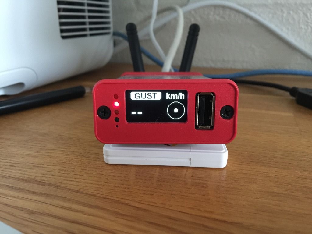

With latest version 10240, I don't see gust or last hour data in display or webpage anymore. Furthermore I've seen FTP problems after running a few hours, and problems uploading to wunderground (something with wget or wput error).

After another reboot, my gust and last hour rain is back... Also stable for the last 24 hour, so I guess problem solved by it self

I noticed delay of sea level pressure, but still no gust or last hour rain in display or webpage. However gust records are recorded and displayed on my webpage.

When I look at the variables you us I see not defined "converters".
[wind0wind-avg1=m/s.1:--] here "m/s" is not defined and results to replacement pattern "--"
[rain0total-sumday=mm.1:--] here "mm" is not defined
When you stay with the ISO units like m/s, mm, hPa, etc... no converter is needed.
Therefore, "[wind0wind-avg1.1:--]" and "[rain0total-sumday.1:--]" will do as you expect.

Thanks for explaning... So this is the reason why display fails on wind and rain?admin wrote:When I look at the variables you us I see not defined "converters".
The strange thing is, that I haven't changed my setup for a long time, and problem came after latest release.
Still I'm missing gust on my webpage - I'll have to dig deeper into this.
