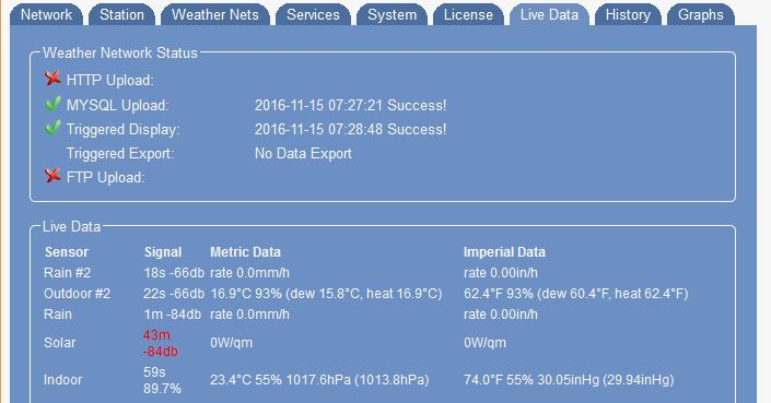

I have needed to restart the PRO three times since 13 November 2016. Uploads give a red X status on the Live Data page and there was no data or graphs available under the History tab. Must I revert the FW or is there a fix coming? The PRO was stable for many weeks prior to 13 Nov.

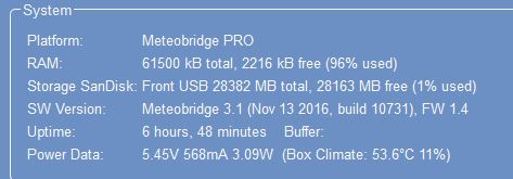

Seeing same or similar issue here. Runs fine for 2 to 3 hours and then random function quit. Got some out of RAM messages earlier, but with latest reboot messages field is blank. Reverting to 3.0 has no issues.

Yes, I have the same problem. I woke up this morning to messages from multiple weather networks saying "You have not sent data in some time."
It seems that, after a period of time, at least Weather Underground successfully got info - for a short time - then stopped again. The times for my messages from Weather Underground were:
3:40AM (California time): Stopped Reporting
4:00AM: Back online
6:40AM: Stopped Reporting
---reboot---
6:50AM: Back online
...obviously the reboot cleared things, but I know it will just fail again soon...

Are there any indications what does go wrong in the system logs?
Do you see RAM usage going up over time? Which might be a root cause (without me understanding why at the moment).
Re: Bug in Meteobridge PRO
Hold on, I found the bug... There are some test messages printing out onto ramdisk which fill up RAM over time.
I just compiled a new version. Please reboot and this problem should have gone.
Sorry for the trouble!
