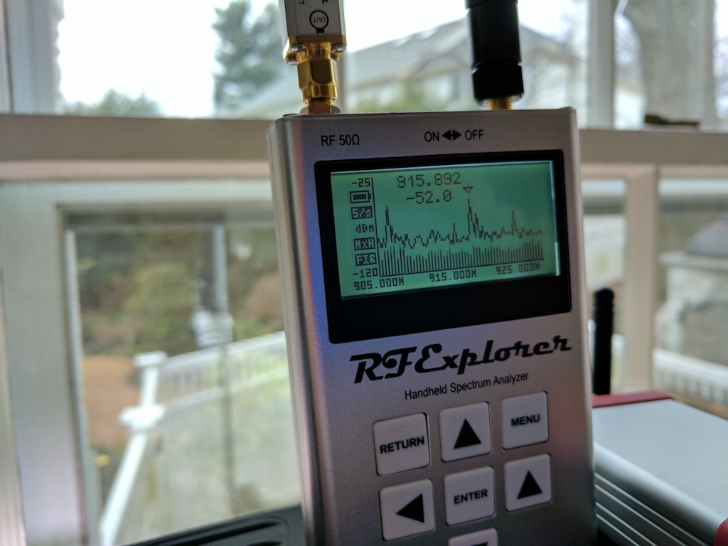

Additional info: the RF environment does not seem to be a problem. Attached is the output from a spectrum analyzer placed next to the MB Pro (you can see the ISS in the background) centered on 915 Mhz. Signal strength consistently is in the -50's and -60's dBm range from the ISS and S/N looks reasonable.

Can you please move the MB PRO to a better, not much IT crowded position and reduce sensitivty to -85db?

Thanks for the suggestion. I reduced the sensitivity, but cannot do much about the environment. I personally do not use any devices other than the weather station that operate in the 900 MHz band (e.g., cordless phone, Zigbee); I do suspect our local electric utility uses this band for our smart meters.

By way of update: reducing the sensitivity appears to have made a significant improvement. I have not seen a drop out for over a day now.
