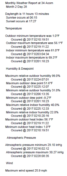

I have been running end of month reports successfully as a "one-time alarm". This month I ran it but also duplicated the "Subj # Body" and ran it as a "before each new month" service. I was hoping to eliminate the constant checking for conditions using the "one-time alarm".

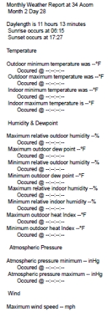

The results were run correctly for the "one-time alarm" run at 11:59 PM but most data missing for the "before each new month" service. What is the problem please?

This is still broken. All entries for before month end are empty once again. Please respond.,

I have the same problem. I had set-up to receive a monthly overview e-mail generated before each month and it is partly empty.
