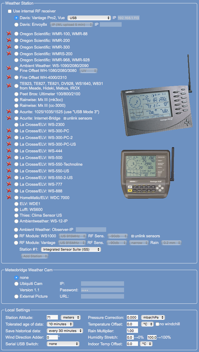

Here is the screen shot today attached for your appraisal. Much appreciate all your help.
JT
JT
- Screen Shot 2017-09-18 at 12.20.49.png (284.55 KiB) Viewed 6320 times

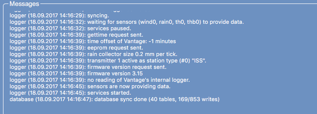

Here is the system comments from today.
JT
JT
- Screen Shot 2017-09-18 at 12.28.13.png (45.87 KiB) Viewed 6319 times

This is baffling too. The Davis Vantage Pro2 is selected as shown yet no green check. As below there are two checks relating to Wifi settings??
Again any thoughts much appreciated. The station dropped sending to the internet stations at 00:50 on the 12th September 2017.
Cheers
JT

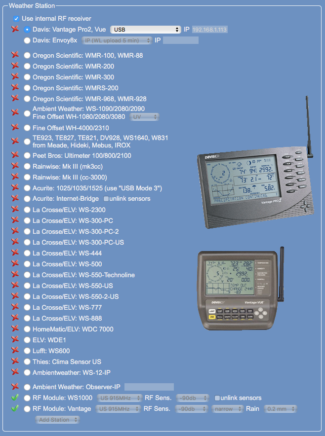

I have re-booted my Davis weather receiver and noticed the internal RF receiver was checked on the station tab of the MBP. I removed this check and the page changed to reflect this. After re-booting the MBP unit having saved settings it now seems to be transmitting as normal. WU is now showing my data (IENGLAND746) as before.
Hope this has been solved, more by trial and luck on my part!
Many thanks again for your feedback.Really appreciated!

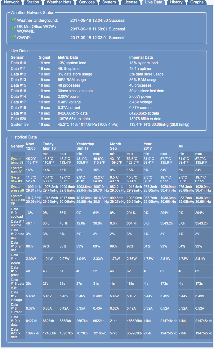

Here are the updated pages and comments from the system.
JT
JT
- Screen Shot 2017-09-18 at 14.47.02.png (81.58 KiB) Viewed 6314 times
- Screen Shot 2017-09-18 at 14.26.44.png (366.82 KiB) Viewed 6314 times

So based on the above screen shots and just to confirm you have a MBPro (red) connected to a USB logger. The MBP (red) is connected via cable to the logger (not wireless to the VP2) & network (as opposed to WiFi)?
Connecting via USB as well as having the use RF internal ticked would have certainly been confusing things a little.
