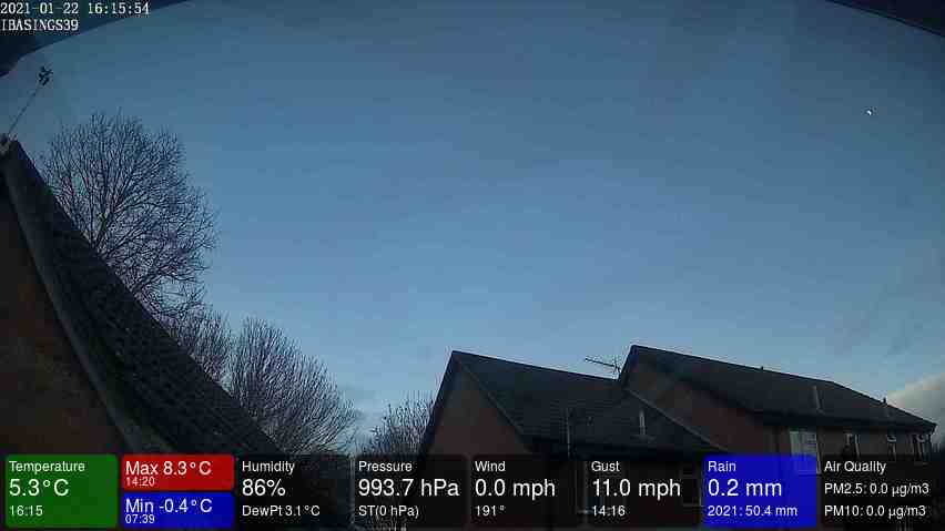

If anyone else is interested here is the overlay code:
The result looks like this:
The top two lines in the picture come from the watermark of the webcam.
-resize 852x480
-fill green -draw "fill-opacity 0.6 roundrectangle 5 410 105 475 5 5"
-fill red -draw "fill-opacity 0.6 roundrectangle 110 410 210 441 5 5"
-fill blue -draw "fill-opacity 0.6 roundrectangle 110 444 210 475 5 5"
-fill black -draw "fill-opacity 0.6 roundrectangle 215 410 315 475 5 5"
-fill black -draw "fill-opacity 0.6 roundrectangle 320 410 420 475 5 5"
-fill black -draw "fill-opacity 0.6 roundrectangle 425 410 525 475 5 5"
-fill black -draw "fill-opacity 0.6 roundrectangle 530 410 630 475 5 5"
-fill blue -draw "fill-opacity 0.6 roundrectangle 635 410 735 475 5 5"
-fill black -draw "fill-opacity 0.6 roundrectangle 740 410 840 475 5 5"
-pointsize 12
-fill white -draw "text 8 425 'Temperature'"
-fill white -draw "text 218 425 'Humidity'"
-fill white -draw "text 323 425 'Pressure'"
-fill white -draw "text 428 425 'Wind'"
-fill white -draw "text 533 425 'Gust'"
-fill white -draw "text 638 425 'Rain'"
-fill white -draw "text 743 425 'Air Quality'"
-pointsize 20
-fill white -draw "text 8 447 '[th0temp-act.1:--]°C'"
-fill white -draw "text 218 447 '[th0hum-act.0:--]%'"
-fill white -draw "text 323 447 '[thb0seapress-act.1:--] hPa'"
-fill white -draw "text 428 447 '[wind0avgwind-act=mph.1:--] mph'"
-fill white -draw "text 533 447 '[wind0wind-dmax=mph.1:--] mph'"
-fill white -draw "text 638 447 '[rain0total-sumday.1:--] mm'"
-pointsize 12
-fill white -draw "text 8 465 '[hh]:[mm]'"
-fill white -draw "text 218 465 'DewPt [th0dew-act.1:--]°C'"
-fill white -draw "text 323 465 '[thb0seapress-delta3h=enbarotrend]([thb0seapress-delta3h=barotrend.2:--] hPa)'"
-fill white -draw "text 428 465 '[wind0dir-avg10.000:--]°'"
-fill white -draw "text 533 465 '[wind0wind-dmaxtime.ij:--]:[wind0wind-dmaxtime.kl:--]'"
-fill white -draw "text 638 465 '[YYYY]: [rain0total-yearsum.1:--] mm'"
-fill white -draw "text 743 445 'PM2.5: [air1!1pm-act.1:--] µg/m3'"
-fill white -draw "text 743 465 'PM10: [air1!0pm-act.1:--] µg/m3'"
-pointsize 16
-fill white -draw "text 113 428 'Max [th0temp-dmax.1:--]°C'"
-fill white -draw "text 113 462 'Min [th0temp-dmin.1:--]°C'"
-pointsize 10
-fill white -draw "text 113 438 '[th0temp-dmaxtime.ij:--]:[th0temp-dmaxtime.kl:--]'"
-fill white -draw "text 113 472 '[th0temp-dmintime.ij:--]:[th0temp-dmintime.kl:--]'"- jasonmfarrow
- Posts: 255
Re: Any way to add a logo to the webcam image overlay?
To increase the picture and text quality I've increased the starting resolution x2. This changed *all* the code to increase dimensions respectively:
The picture improvement can be seen here: https://admin.meteobridge.com/cam/07909 ... 0123212110. Picture quality is not good at night but then it was the cheapest camera I found that would do the job (Foscam C2M)
Ps.: The above code can be cut'n'pasted straight into the meteobridge. There is no need to put this into one long line of code.

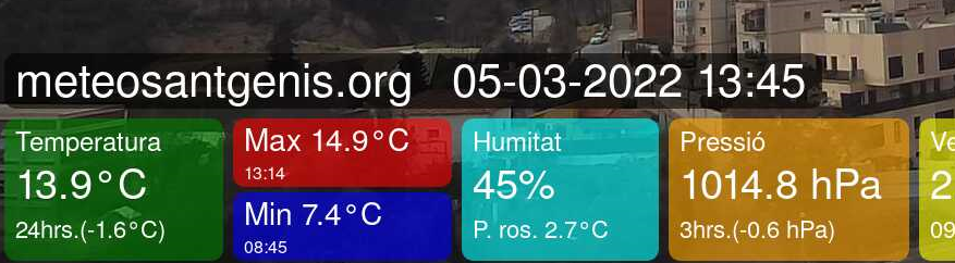

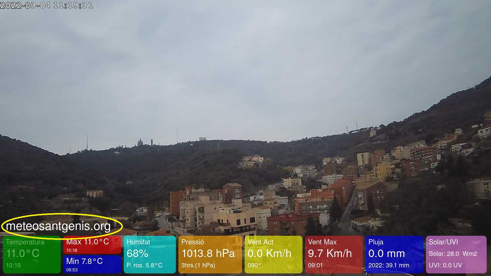

Good morning,
Great job !!!!!
How to add a transparent background to the url ?
Great job !!!!!
- jmontamat
- Posts: 267
- Location: Barcelona Spain
In the end I got it, trial and error with meteobridge every 5 minutes.
For size 1706x960
add :
-fill black -draw "fill-opacity 0.6 roundrectangle 10 760 760 810 10 10"
For size 1706x960
add :
- Sin título.png (355.96 KiB) Viewed 5771 times

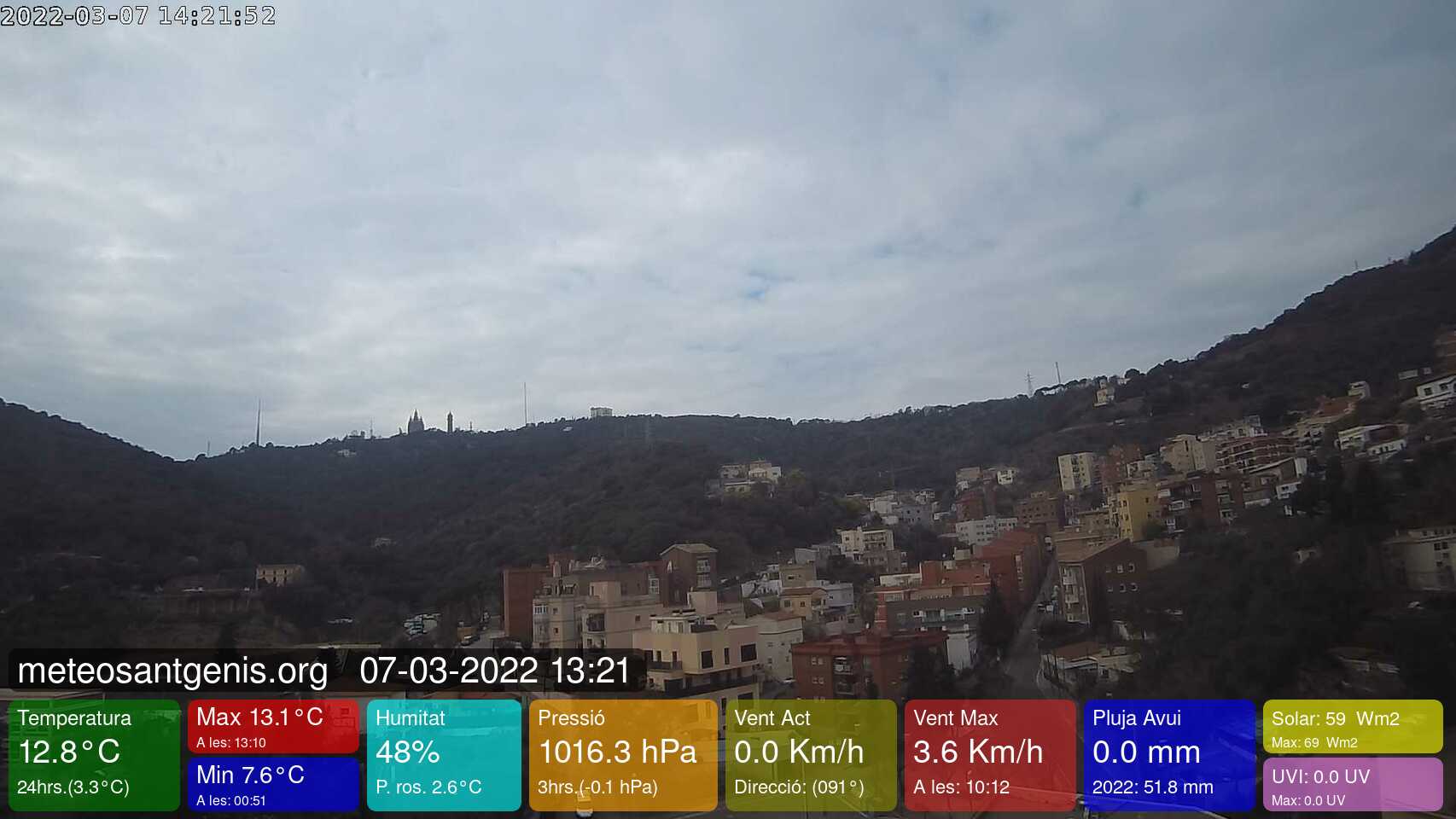

- jmontamat
- Posts: 267
And the complete code in English with solar and UV.
Thanks Simon, Jason for sharing his wonderful script.
-resize 1706x960
-fill green -draw "fill-opacity 0.6 roundrectangle 10 820 210 950 10 10"
-fill red -draw "fill-opacity 0.6 roundrectangle 220 820 420 882 10 10"
-fill blue -draw "fill-opacity 0.6 roundrectangle 220 888 420 950 10 10"
-fill cyan -draw "fill-opacity 0.6 roundrectangle 430 820 610 950 10 10"
-fill orange -draw "fill-opacity 0.6 roundrectangle 620 820 840 950 10 10"
-fill yellow4 -draw "fill-opacity 0.6 roundrectangle 850 820 1050 950 10 10"
-fill firebrick3 -draw "fill-opacity 0.6 roundrectangle 1060 820 1260 950 10 10"
-fill blue -draw "fill-opacity 0.6 roundrectangle 1270 820 1470 950 10 10"
-fill yellow -draw "fill-opacity 0.6 roundrectangle 1480 820 1690 882 10 10"
-fill violet -draw "fill-opacity 0.6 roundrectangle 1480 888 1690 950 10 10"
-fill black -draw "fill-opacity 0.6 roundrectangle 10 760 757 810 10 10"
-pointsize 24
-fill white -draw "text 20 850 'Temperature'"
-fill white -draw "text 440 850 'Humidity'"
-fill white -draw "text 630 850 'Pressure'"
-fill white -draw "text 860 850 'Wind Act'"
-fill white -draw "text 1070 850 'Max Wind'"
-fill white -draw "text 1280 850 'Rain Today'"
-pointsize 38
-fill white -draw "text 20 894 '[th0temp-act.1:--]°C'"
-fill white -draw "text 440 894 '[th0hum-act.0:--]%'"
-fill white -draw "text 630 894 '[thb0seapress-act.1:--] hPa'"
-fill white -draw "text 860 894 '[wind0avgwind-act=kmh.1:--] Km/h'"
-fill white -draw "text 1070 894 '[wind0wind-dmax=kmh.1:--] Km/h'"
-fill white -draw "text 1280 894 '[rain0total-sumday.1:--] mm'"
-pointsize 22
-fill white -draw "text 20 930 '24hrs.([th0temp-delta24h:--]°C)'"
-fill white -draw "text 440 930 'P. ros. [th0dew-act.1:--]°C'"
-fill white -draw "text 630 930 '3hrs.([thb0seapress-delta3h:--] hPa)'"
-fill white -draw "text 860 930 'Bearing: ([wind0dir-avg10.000:--]°)'"
-fill white -draw "text 1070 930 'At: [wind0wind-dmaxtime.ij:--]:[wind0wind-dmaxtime.kl:--]'"
-fill white -draw "text 1280 930 '[YYYY]: [rain0total-yearsum.1:--] mm'"
-fill white -draw "text 1490 850 'Solar: [sol0rad-act.0:--] Wm2'"
-fill white -draw "text 1490 918 'UVI: [uv0index-act:--] UV'"
-pointsize 28
-fill white -draw "text 230 850 'Max [th0temp-dmax.1:--]°C'"
-fill white -draw "text 230 918 'Min [th0temp-dmin.1:--]°C'"
-pointsize 16
-fill white -draw "text 230 876 'At:: [th0temp-dmaxtime.ij:--]:[th0temp-dmaxtime.kl:--]'"
-fill white -draw "text 230 944 'At:: [th0temp-dmintime.ij:--]:[th0temp-dmintime.kl:--]'"
-fill white -draw "text 1490 876 'Max: [sol0rad-dmax.0:--] Wm2'"
-fill white -draw "text 1490 944 'Max: [uv0index-dmax:--] UV'"
-pointsize 42
-fill white -draw "text 20 800 'meteosantgenis.org [DD]-[MM]-[YYYY] [hh]:[mm]'" - Attachments
- camplus.jpg (92.31 KiB) Viewed 5735 times
