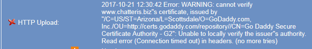

I have recently moved servers within GoDaddy and this broke the SSL certificate, I have rekeyed but get an error from Meteobridge (image attached), my landing page is incredibly slow to load, would this cause the problem due to a time out, or do I need to flush anything within the Meteobridge so that new certificate details are exchanged

Please ignore the certificate warning. The interesting part is at the end: "Connection timed out"
This tells that target URL cannot be reached for some reasons.

Same topic as this one, http://www.wxforum.net/index.php?topic=33058.msg334858
Problem caused by "non functional" IP6 DNS server at some (most?) of the Godaddy servers in Europe.
To much PHP scripts are waiting for data until time-out occurs and or number of allowed concurrent php scripts is exceeded.

Moved back to the North America servers from European as per Wims' suggestion, problem solved.
