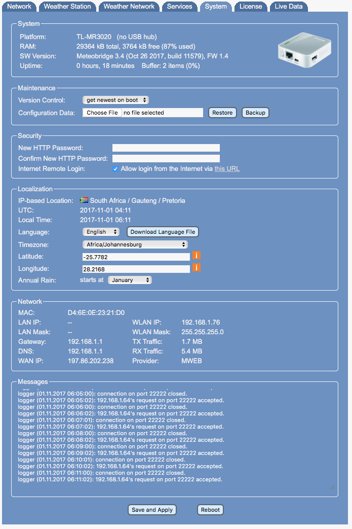

Leon
Posts: 63
Re: Meteobridge „service unavailable“
Post by Leon »
Same problem here...
see screenshot.

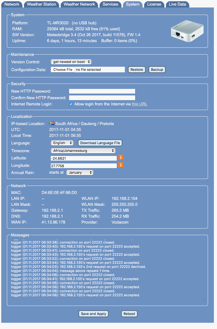

Leon
Posts: 63
Post by Leon »
Interestingly I have 3 devices of which one I can still login remotely and 2 I can not log in remotely.
I have not changed any thing.
Screenshot of working one below :
