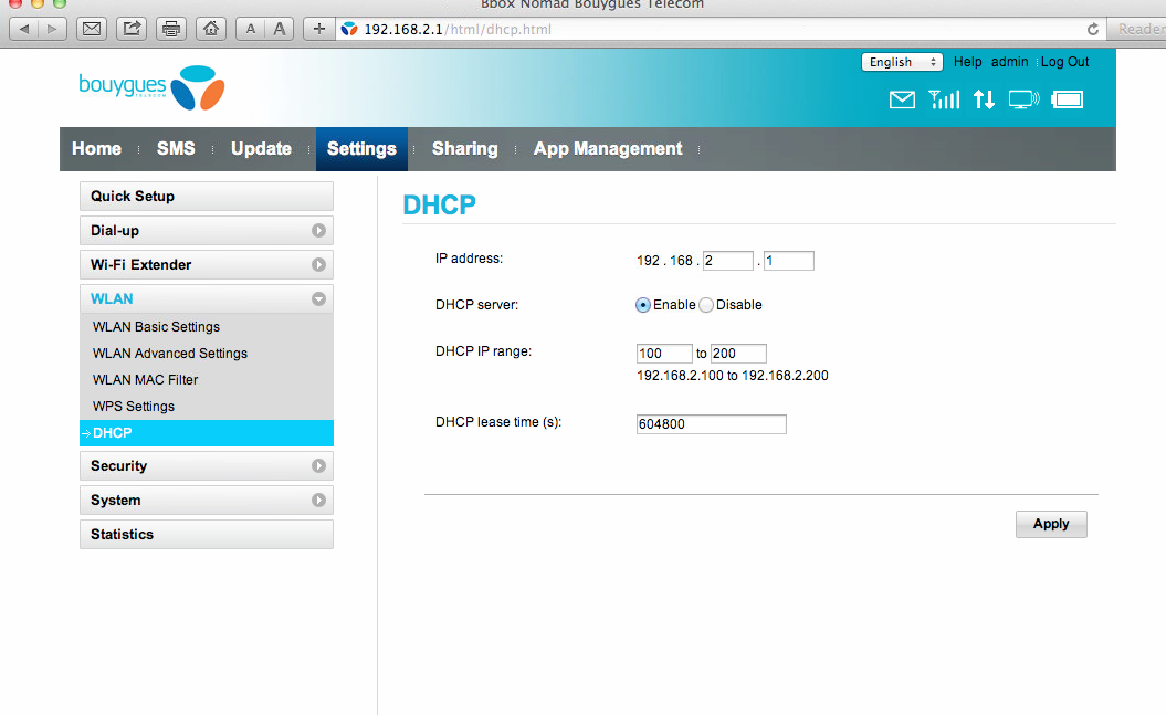

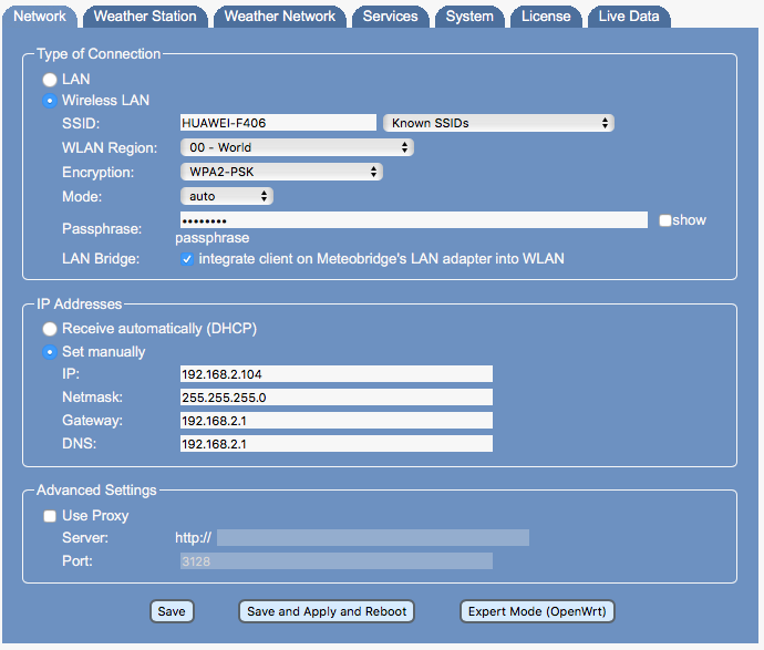

Colin if I understand you correctly you want to connect the meteobridge device to a Huawei E5377 modem.
I have 3 meteobridge devices connected to Huawei modems wirelessly (they are very similar to E5377)
See screenshot of meteobridge and modem web interface
Screen Shot 2017-12-02 at 13.32.04.png (178.71 KiB) Viewed 3667 times
Screen Shot 2017-12-02 at 13.29.01.png (81.27 KiB) Viewed 3667 times
Make sure you set a fixed ip address on your meteobridge (in my case 192.168.2.104)
See the WIKI on setting up network in meteobridge.com home page
Hope this helps :D

Did not work. Meteobridge just cannot find the Internet. Works on home wireless network, just not this device.
Re: Mobile Broadband
setting DNS to 8.8.8.8 might do the trick.
Colin
Posts: 17
Joined: Mon Aug 17, 2015 12:30 pm
Post by Colin »
It certainly was a good trick. It now connects okay and can now connect Meteobridge to the Huawei device.
Thanks very much :D :D
