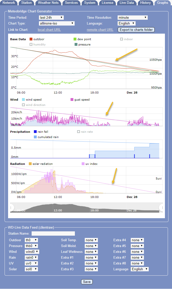

Is there a setting to turn off the lines as indicated on my chart below? I'm not sure what they are trying to tell me.
Thank you
Rob

Re: Meteobridge Chart Query
oops, this is funny. I have no idea.
Can you please give me a remote login? Please send credentials to "info(at)meteobridge.com".

Progress has been made thanks to Boris, it seems the problem with the trends is with the browser Chrome. trends display as they should in Firefox and Microsoft Edge.

Regarding the disturbing lines this seems to be a browser related issue. It does show on Chrome sometimes, while other browsers don't seem to be impacted. Looks like amchart has released a fix, which I will give a test drive.
Update 3.21.11
    Some rendering issues because of a bug in new Chrome release fixed.
