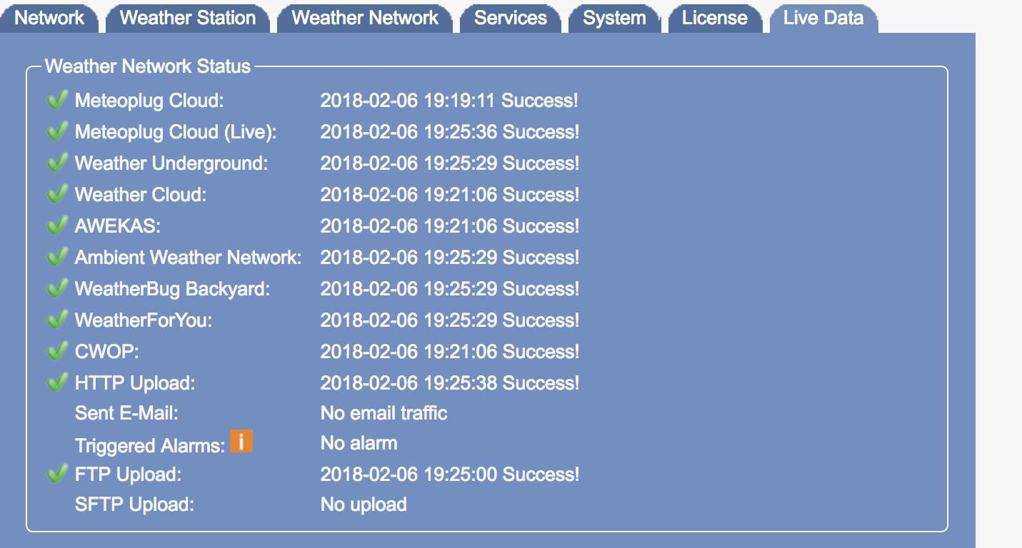

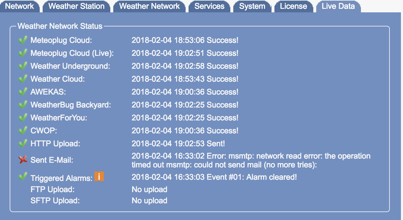

Looks like on or about 22/Jan/2018, MeteoBridge stopped uploading via sFTP.
Why?
A reboot had the FTP start again, but I'd prefer sFTP. Did that get broken?
Larry Rosenman
Round Rock, TX USA
http://sienawx.com
Re: Why isn't sftp uploading?
"no upload" tells that the service has not been started. Can you please share a screen dump of the services page, where the FTP/SFTP service is defined?

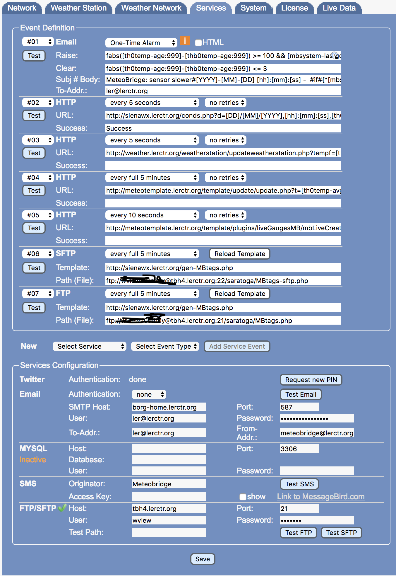

lrosenman
Posts: 72
Joined: Thu Jul 31, 2014 8:13 pm
Post by lrosenman »
Here ya go.
Larry Rosenman
Round Rock, TX USA
http://sienawx.com

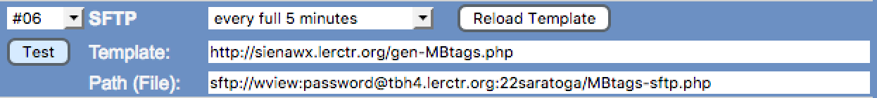

Service #6 is defined as SFTP but it has a legacy FTP upload command in it "ftp://...". That does not fit. If it is selected as SFTP then it needs a SFTP fitting destination defined in Path field and vice versa. Did you try replacing "ftp://" by "sftp://"? You should also be able to strip the "ftp://" header, then the protocol is selected by the defined service.
Service #7 looks fine for legacy FTP execution.
lrosenman
Posts: 72
Post by lrosenman »
admin wrote: Wed Feb 07, 2018 10:09 am Service #6 is defined as SFTP but it has a legacy FTP upload command in it "ftp://...". That does not fit. If it is selected as SFTP then it needs a SFTP fitting destination defined in Path field and vice versa. Did you try replacing "ftp://" by "sftp://"? You should also be able to strip the "ftp://" header, then the protocol is selected by the defined service.
I removed the ftp://un:pw@host, and it still shows no upload.
Larry Rosenman
Round Rock, TX USA
http://sienawx.com
Sorry, I don't understand the " ftp://un:pw@host" removal remark.
Which service definition do you speak of? #6 or #7 and what exactly did you change?

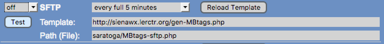

lrosenman
Posts: 72
Post by lrosenman »
Larry Rosenman
Round Rock, TX USA
http://sienawx.com
When you remove all SFTP services from "Services" tab then "Live Data" tab is also expected to no longer show an SFTP entry. I checked with my system and it works es expected. Please double check.
lrosenman
Posts: 72
Post by lrosenman »
I re-added it, and I removed (per your suggestion) the ftp://user:pass@host:port/ and left the /path/file portion.
The live data tab shows sftp no upload.
Larry Rosenman
Round Rock, TX USA
http://sienawx.com
