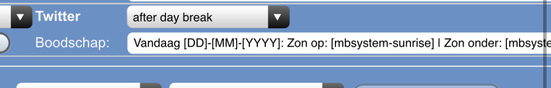

I’m trying to send a daily Tweet “before daybreak” or “after daybreak” but none of them aren’t sending. Can you please tell me how to get it right?

But I’m not sure I understand your question, the picture send with my first question is the
parameter I’m using for Twitter messages with my MB pro. I’m using the “after daybreak” but then it sends out a tweet just after midnight. Unfortunately it’s not sending a tweet after daybreak, witch is at the crack of dawn ;-) Although that’s complicated because every day is another daybreak moment, so probably not possible.
Hope you’ve got what you were looking for in my answer
Re: Twitter service “before daybreak” ain’t working
I think this is a misunderstanding. "after day break" does mean 23:59 just before the new day starts and does not depend on any sunset/sunrise settings.
