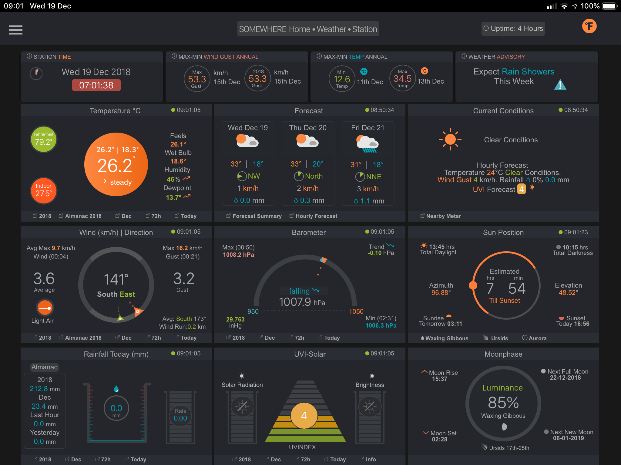

I have enabled HomeWeatherStation Dashboard on my NANO SD and can access it via my tablet and phone data upload correctly and on tablet I can access graphs etc !!
But I have a couple of questions.

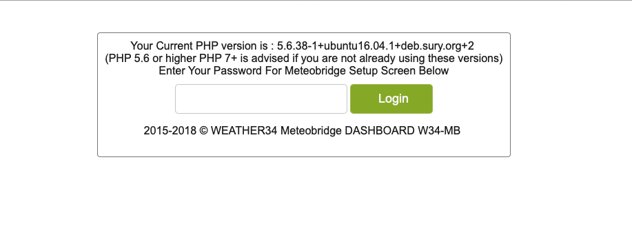

Can I change the settings ?
When I log into settings I am asked for a password.
The weather station time displays UTC time and not local...can I change that.
The name says somewhere weather station....can I change that.

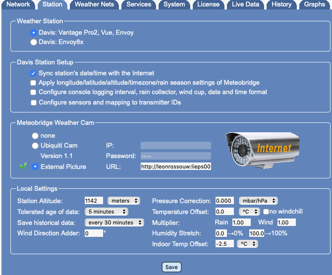

It does not access my web cam but a different one.

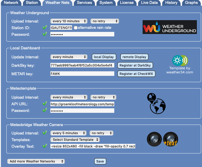

I have Meteobridge camera enabled and local URL uploads...I can see cam with overlay in my meteotemplate web site.
Please see attachments.

Yes change the settings, first time into settings leave box blank and click login, change whatever settings you want including password as you wis, remember to Save.

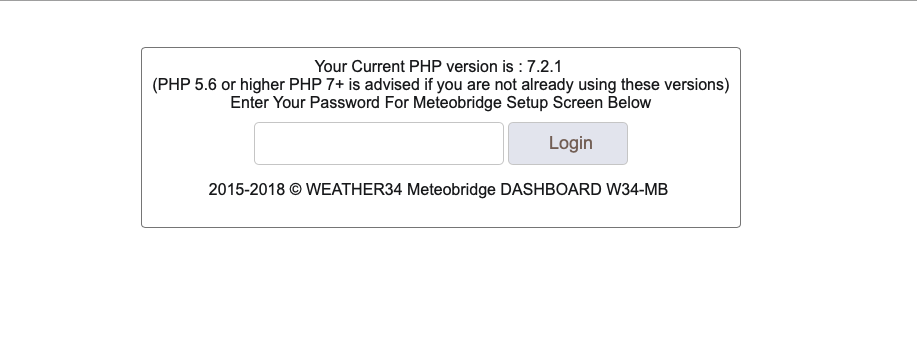

I get to the login screen and leave it blank and when I click there is a different message...please see screen shots.

Thank you Matt that is exactly the problem that I am having (as in the link above)
However I have now disabled all add / pop blockers etc. without any joy.
I have tried Safari,Chrome,Opera,Firefox on Mac os and I have tried on iOS....no joy.
I can not think of anything else and have given up :roll:
