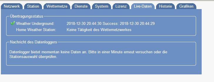

many thanks to Boris for this MBpro update,
but after this update the internal Datalogger of the MBpro does'nt work Best regrads

Seeing the same thing here with latest version. Seems to stuck in loop. Log below.

Re: home weather station template with MBPRO
I made a mistake in the very latest update, before I was off for two days. bug is fixed now. Sorry for that.
Please reboot, get newest version by that and it should be fine again.
thank you, the MBpro runs again perfect
best regards
