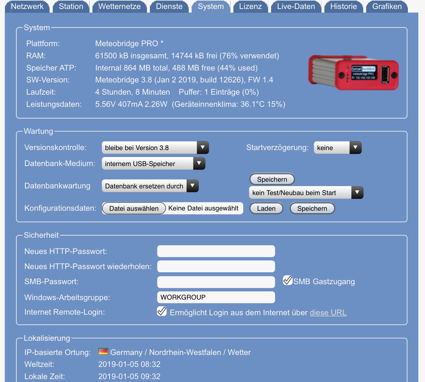

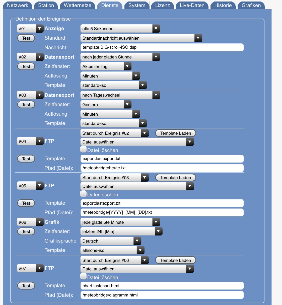

Hello Mattk,
this morning i rolled back the mb to version 3.8 and i am waiting what happens now and give you a feedback.
Yesterday i have made a factory reset but after only a few hours the mb stopped generating and exporting the html charts and txts. The live data were available and also the live graph on the webinterface of the mb pro was up to date.
The first time the problem occurred was at the end of 2018 as i changed the sensor from davis to lufft ws600. So after the reboot at this time it must have had the 3.8 version
Best regards Bastian
- 90DD0F7C-7DF9-4A2C-96DB-727AB065D7B6.jpeg (316.11 KiB) Viewed 2684 times
- 06DECB73-CB13-4DFA-A633-63B178987F8C.jpeg (384.65 KiB) Viewed 2684 times
