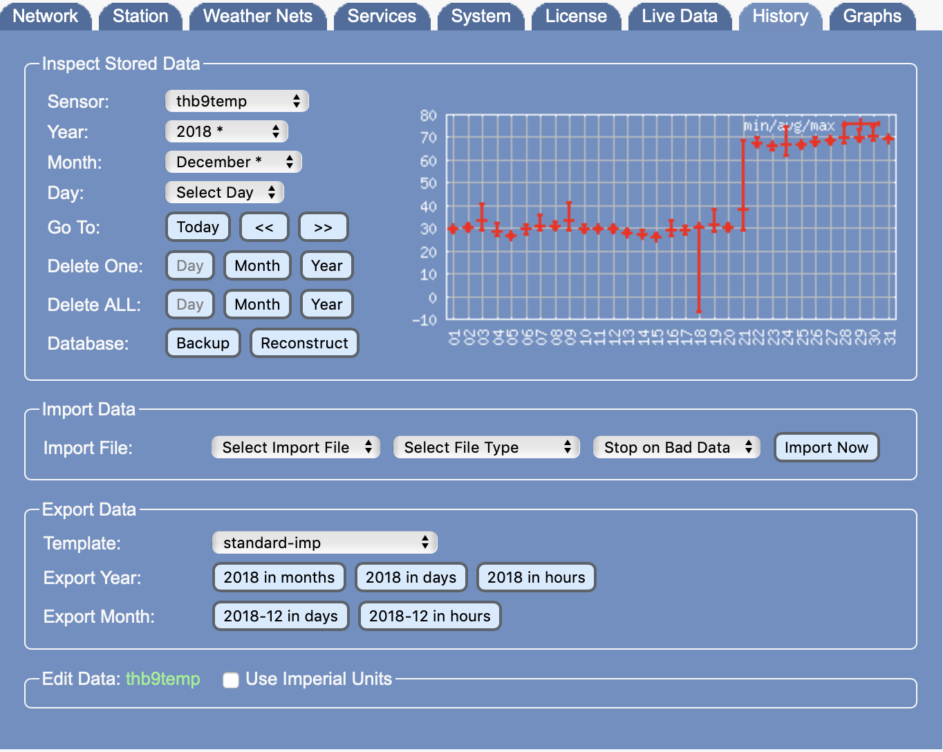

The Meteobridge Pro Red is in my caravan and communicates with the ISS directly rather than through the console. Although most people will not be bothered about interior humidity, I found it quite useful as I use calcium chloride dehumidifier traps and the internal humidity sensor is a useful guide to when the calcium chloride needs replaced and a visit is required. I check the interior humidity every 6 weeks by logging into the MBPro red's web interface. I was surprised to find internal humidity had stuck on 30% since the 21st December. Digging about in the other data, I have found that on the 21st December there was also a sudden increase in box climate temperature at about 18:00hrs from about 32C to about 65C!
Screenshot 2019-02-03 at 17.38.49.png (382.97 KiB) Viewed 3252 times
The MBP Red had been running at that temperature since then. (A valuable lesson to me is to log in and check more regularly.)

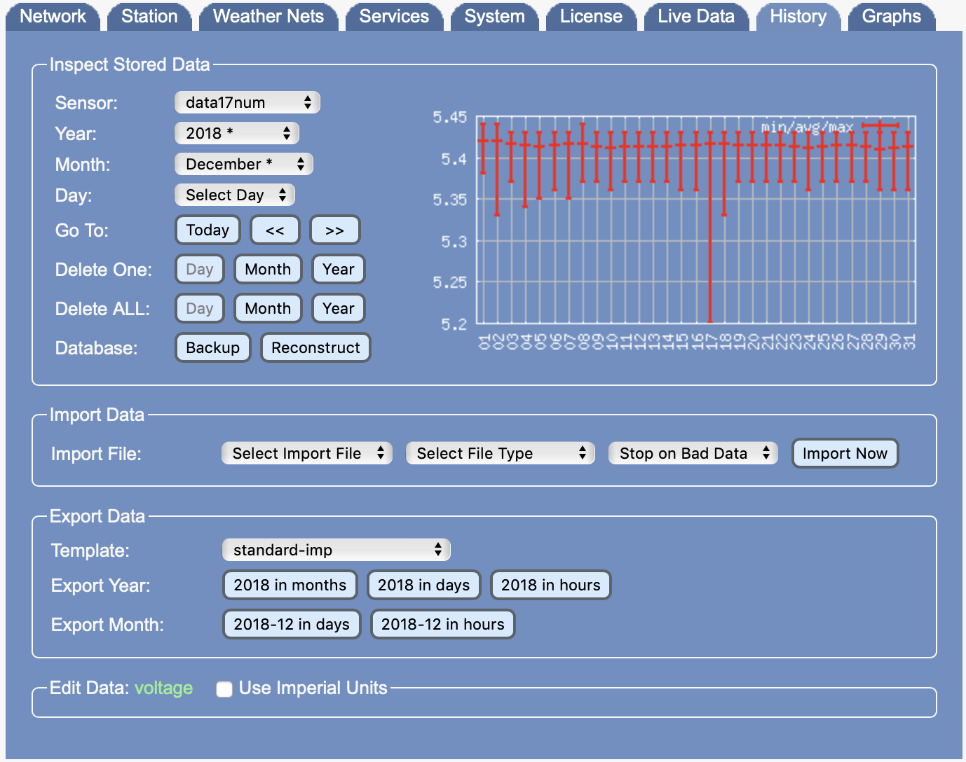

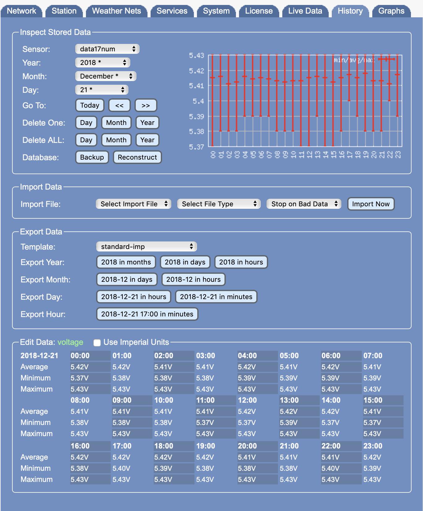

The supply voltage seems stable before after and during the 21st December:

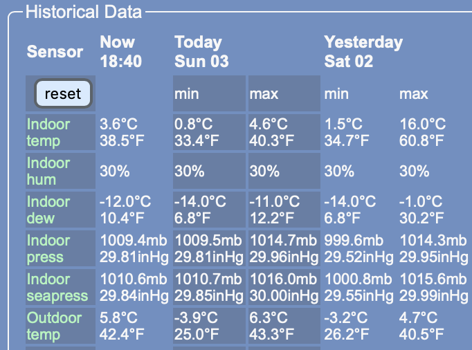

It may be that the temperature sensor is faulty rather than the unit is running at 65C. Somewhat surprisingly, the indoor temperatures still make sense. I have an indoor temperature offset of -17.4 degrees. The caravan has full height and width double glazed glass wall on its SSE facing side and so it heats up when it is sunny.
Screenshot 2019-02-03 at 18.45.05.png (130.03 KiB) Viewed 3248 times
Today which was cloudy 3/2/2019 the indoor temperature was 0.8C min to 4.6C max compared with outdoor temp -3.9C 6.3C max.
Yesterday which was full sun all day 2/2/2019 the indoor temperature was 1.5C min 16.0C max compared with outdoor temp -3.2C min 4.7 max.
