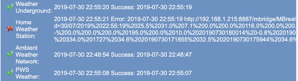

It doesn't look like any charts or realtime data is updating. The php files on the server have not been modified. So, i'm either thinking it is a issue with the URL for Home Weather STation in the Weather nets section of the setup. I'm using http://yourdomain/mbridge/MBrealtimeupload.txt with my domain changed to the right one or i've tried the IP address of the server directly. I'm planning to eventually move this to a hosting service.
I thought it was a permissions issue and changed the permissions on the files for R/W for everyone. at least thru the mac GUI. I guess i should look at it via terminal.
Here is the screenshot of the error.
Screen Shot 2019-07-31 at 11.17.23 AM.png (85.42 KiB) Viewed 2037 times

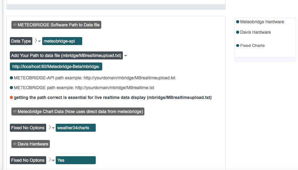

you will need to verify meteobridge can see the localhost or server . hence the red cross indicates it can not be reached .
which port ? http://<ip>:<port>/
i use Xampp on an old 2009 mac mini that is just acting as a server without a keyboard or monitor .
path if accessible/viewable to meteobridge I use simple localhost:80/folder/file in my case
http://localhost:80/Meteobridge-Beta/mbridge/mb.php

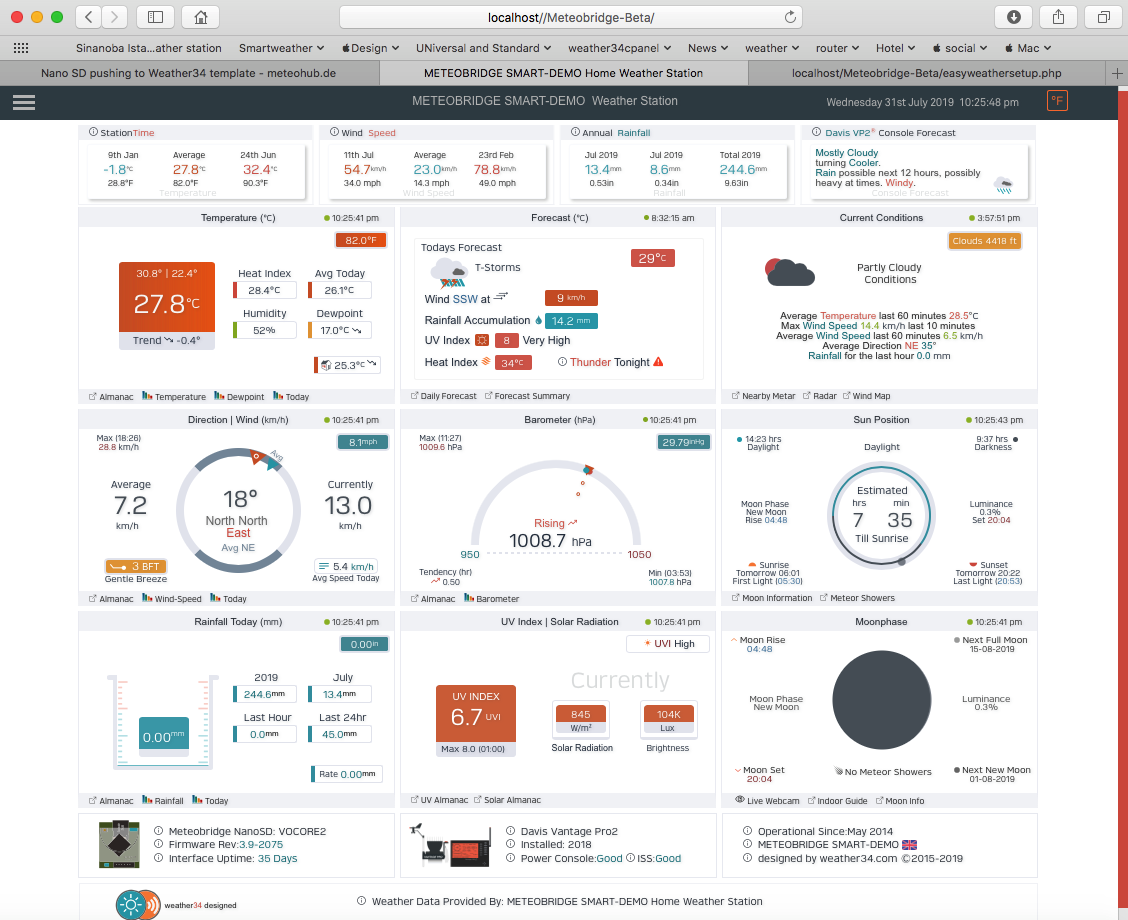

screenshot running on localhost realtime. edit forgot to add path screenshot ..
Screenshot at Jul 31 22-25-58.png (414.16 KiB) Viewed 2021 times
